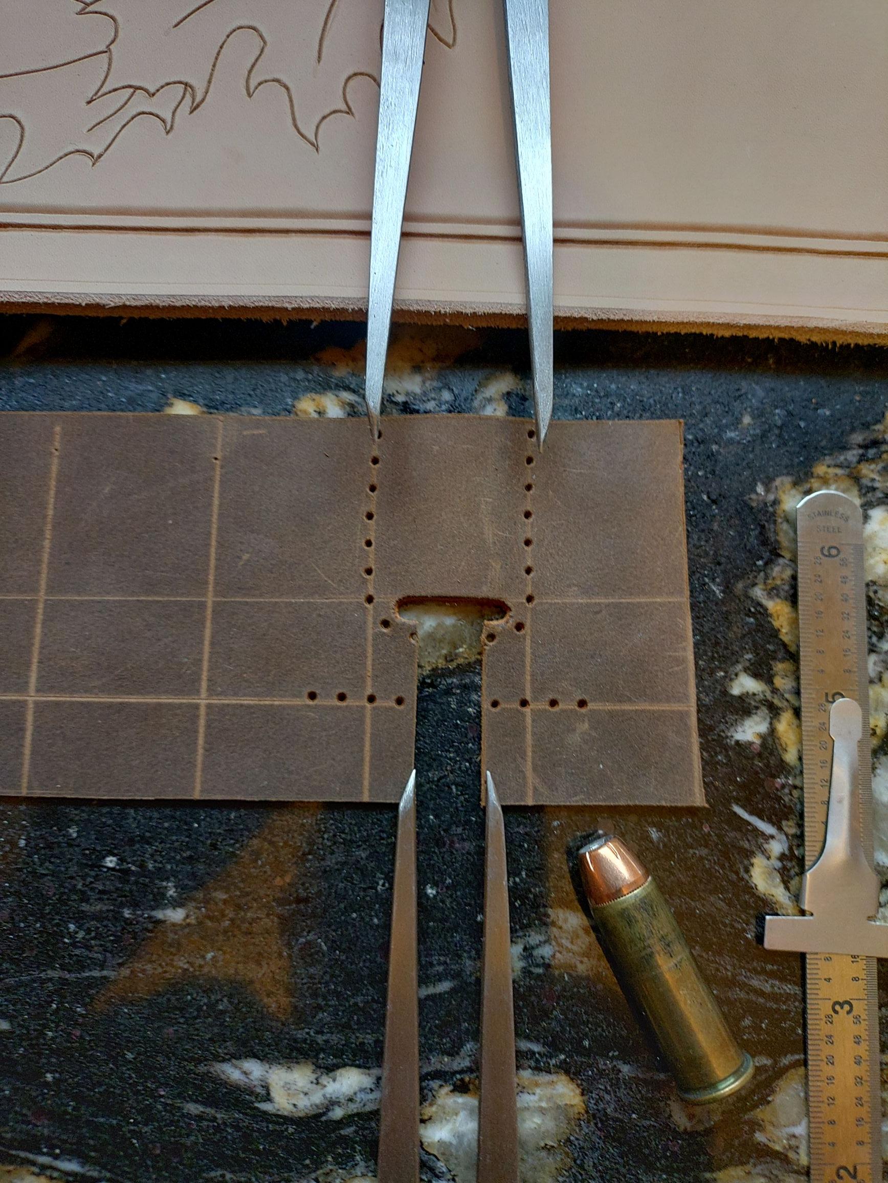

  2. So I was waiting for leather to dry a little and thought I would fiddle with this. The removed material at the bottom needs to be the diameter of the cartridge (in this case .429" -44 mag) The oval punch should be close to that plus the thickness of the leather doubled (.429 + leather doubled) The stitching down the case wall needs to be measured with a couple strait edges holding the leather and bullet down to a flat surface. In my attempt, my punched hole is a little too long. The stitching holes I just eyeballed the radious going under the bullet. Knowing these measurements I think I could build a pattern. Then the stitching on the back piece I think would be like a normal piece except the radioused part under the bullet might need to be punched during assembly? On a bottle neck case, Ill probably have to work that out but I think the oval hole might need to be higher?

  22. Tell us about the leg bags. Boat seats are typical "upholstery" which works great on a flatbed walking foot. But when you start talking bags then you have gussets. And if you've ever stitched a stiff gusset on a bag with a flatbed machine you will wish for a cylinder bed or post bed. 😀 What type of images? What is the filesize? Sometimes there are filesize restrictions, so scaling the image down to 1000x1000 pixels gets it under the bar.
  23. Here is a link to my experience with re-dying shoes. It may help, maybe not but it may give you some ideas. kgg
