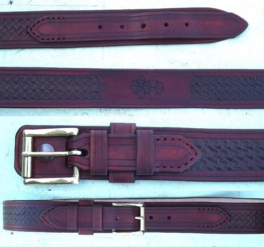

After several weeks and trips, I thought I would give an update. So far, the edges are holding up nicely. the “ antiquing” was also done with the acrylic paint, though it did leave a faint shmear, its not really noticeable. Richard
