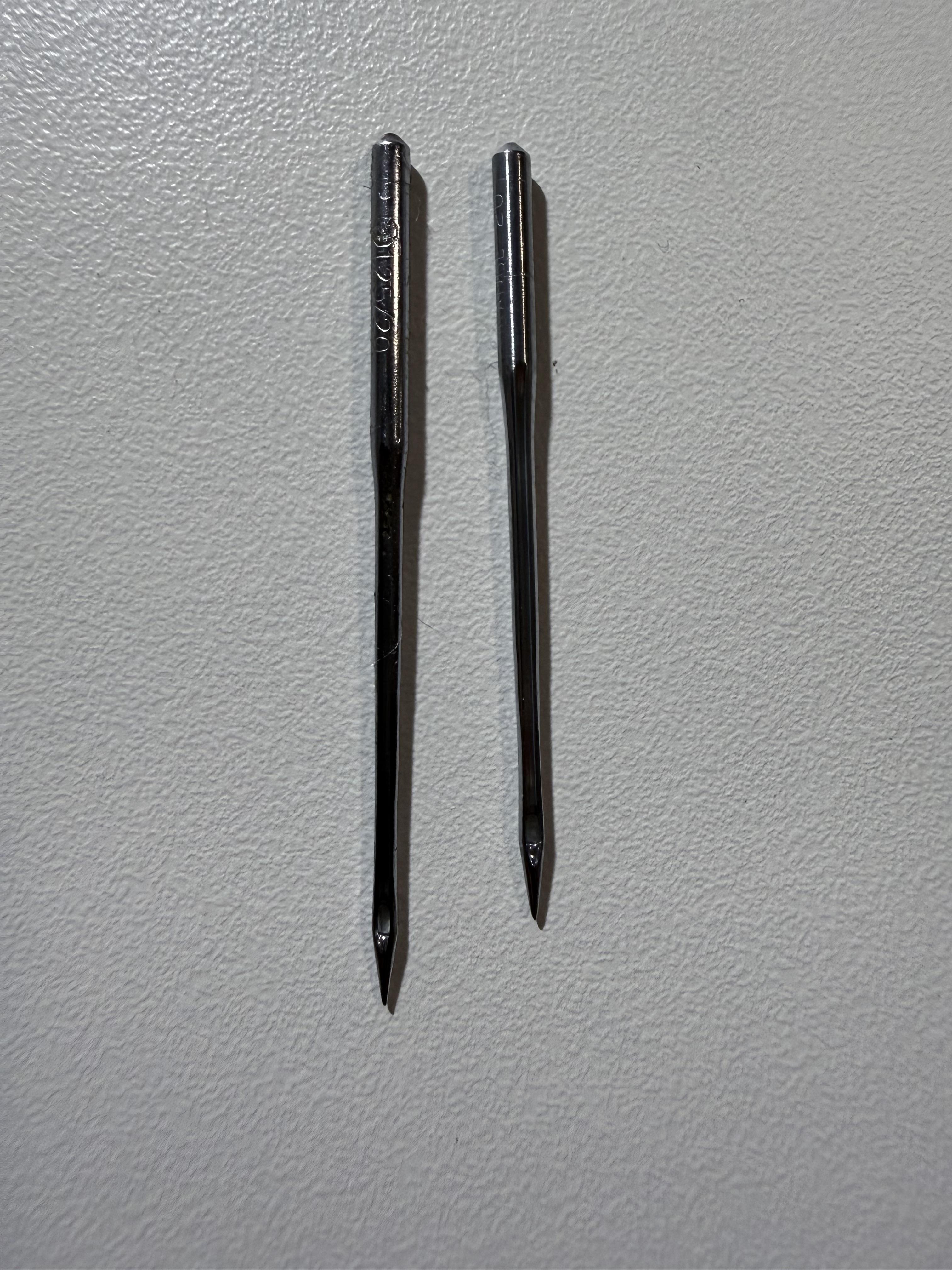

@wizcrafts Thank you for the article! I would definitely be concerned about needle deflection and I don't think I'd be up for going through that adjustment process very frequently. I'm also not too keen on trying to source hard to find needles as well! I'm more convinced it's a case of two machines. Thinking about it more, I believe my best bet is to get a 1341 class machine now as I think it would fill a larger number of needs, while saving the super heavy stuff for an eventual 441 class machine. Side note, I'm assuming Toledo doesn't carry the 6900 as is not on their site. Maybe I'll call and see what Bob says. That's a good point. I've seen some other posters say they've done it with 207 in the top but not the bobbin but I think 138 is a safer bet.

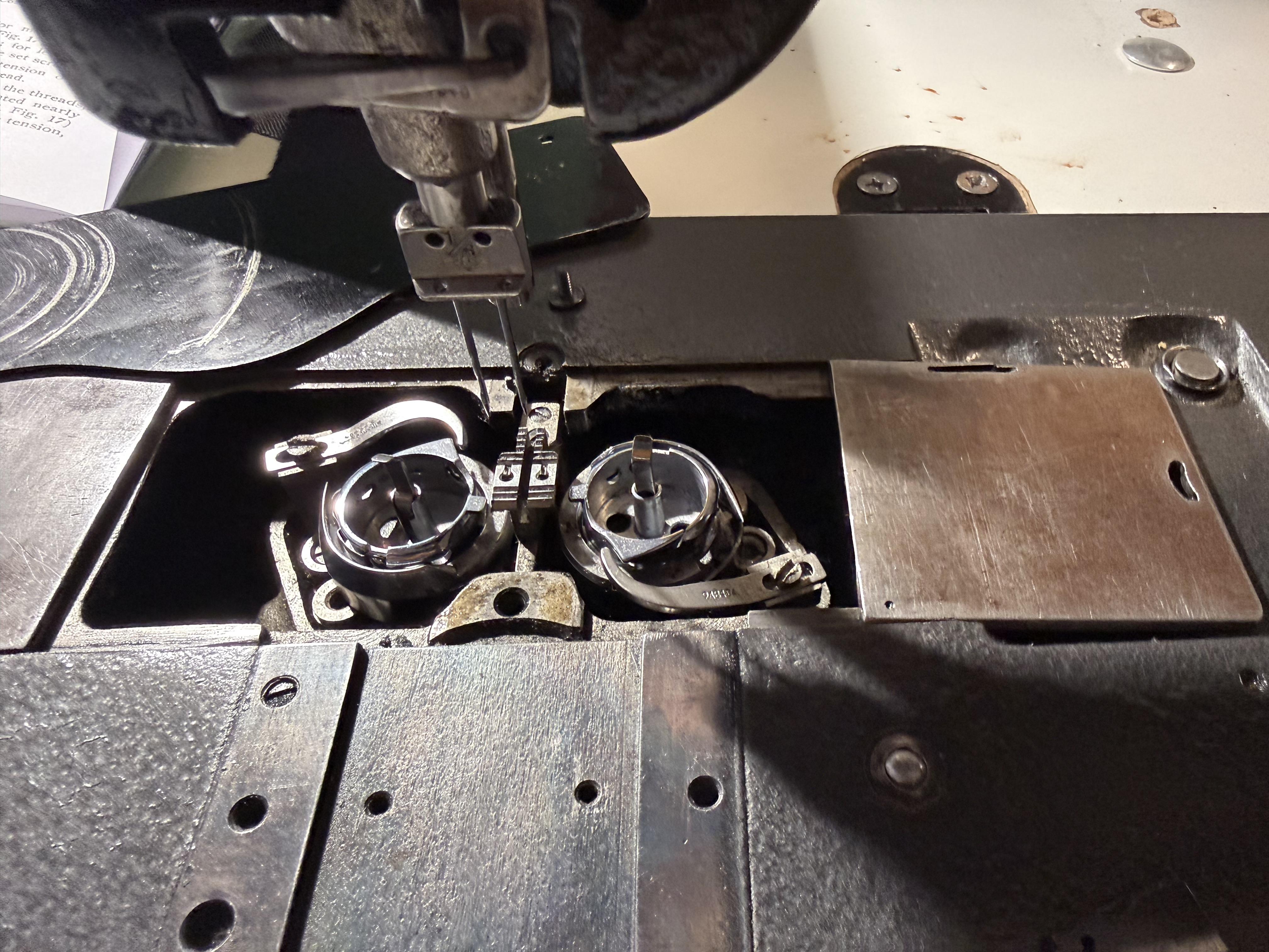

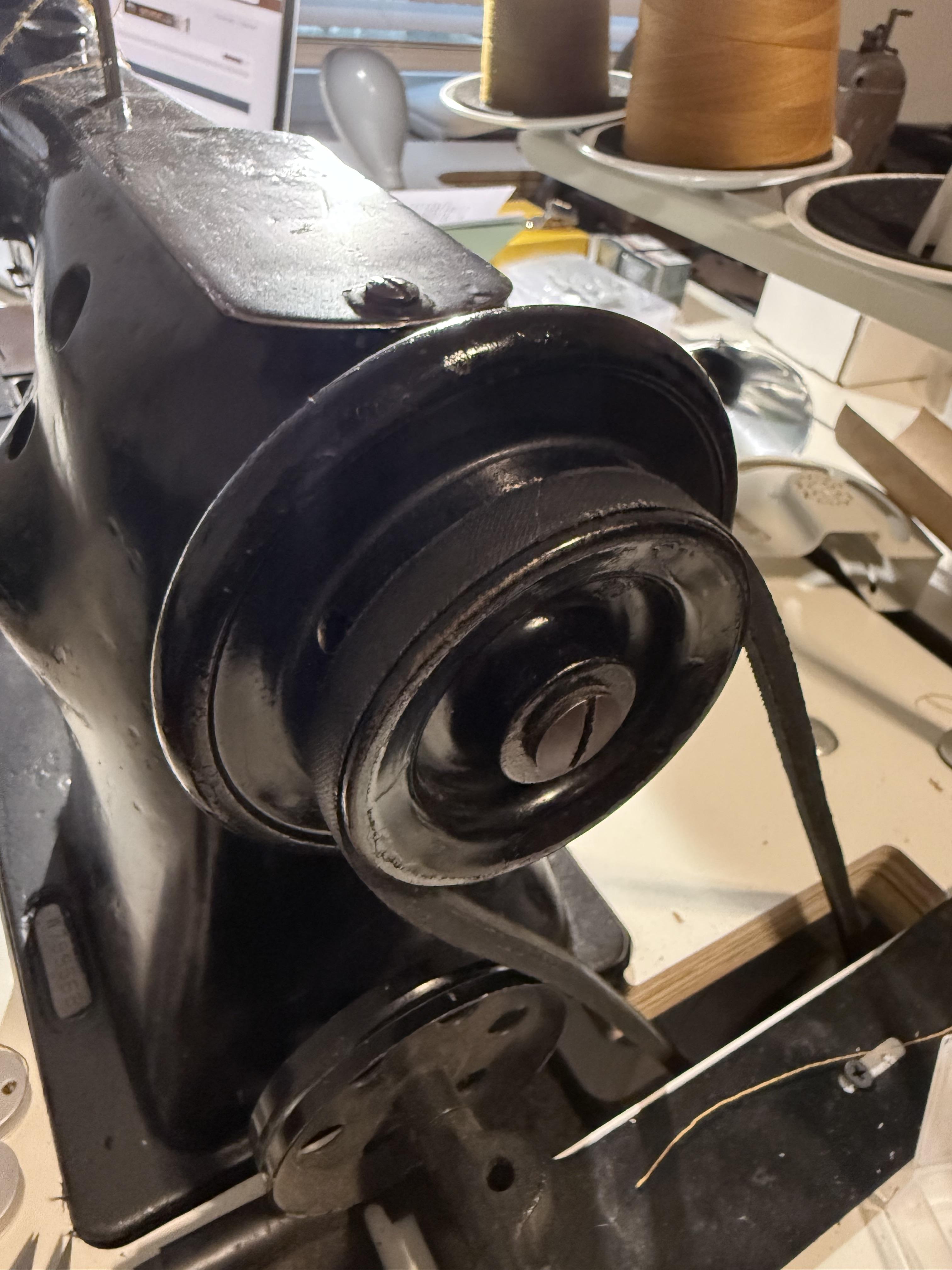

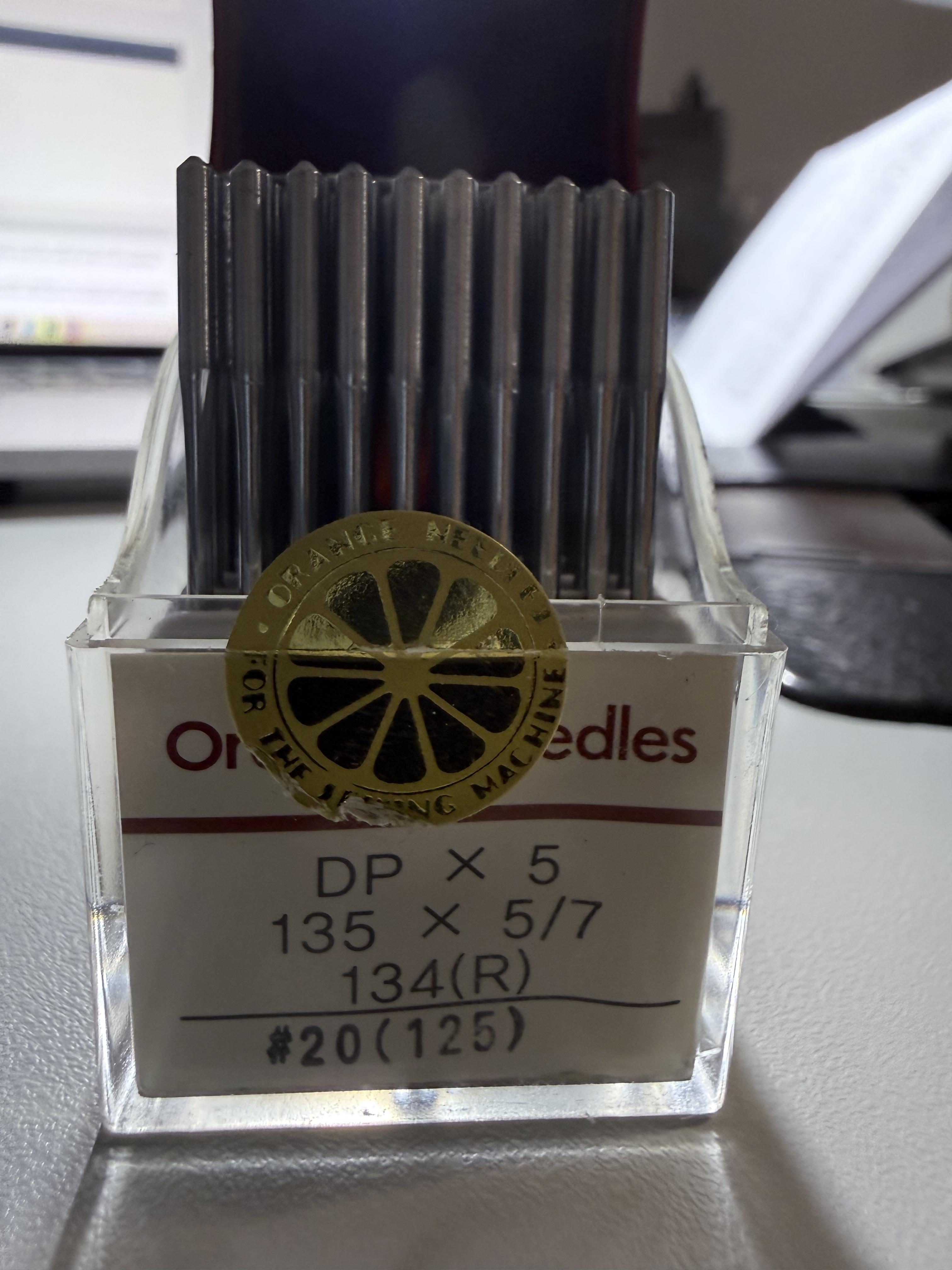

I need some helping locating information online on adjusting the hook timing on my double needle drop feed Singer 112w 115. I'm moving to a larger needle (20) and need to know how to adjust the timing for these types of machines. I have a needle bar that has no marks. The instructions for this machine says it can still be done even without marks on the needle bar, but also says I should set the stitch length to 8. I'm not sure when I change the stitch length if it actually changes. I bought this machine from a couple on Facebook marketplace that has an upholstery business, but I have not had much luck with consistent operation since I purchased it a few months ago. Everything from getting the right size table top from a swing machine supplier I would never use again to installing a simple knee lifter that turned out to be made horribly especially with this terribly made table top.
