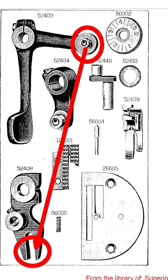

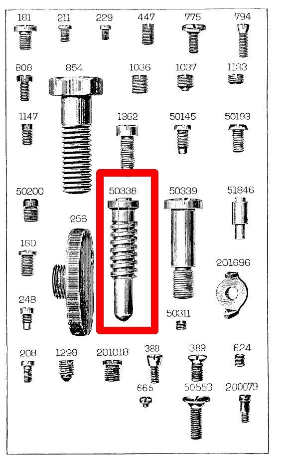

  2. I found one of my mistake and corrected.But there are still problems. I was trying to attach numarator disk(56032) without removing the screw rod(50338). First I removed 50338 from machine and then attached 56032 to it. After that insert them into machine ,then pin and spring. Now, numarator part is working but although I attached the reverse pedal connector(52409) to the fork type metal part(52408) when I try to start machine, reverse pedal lever drops down and stitch moves backwards. I think there is no suitable connection between reverse lever and numerator part. How can I do this?

  6. Thank you AlZilla
