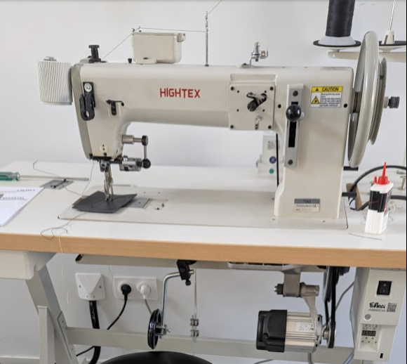

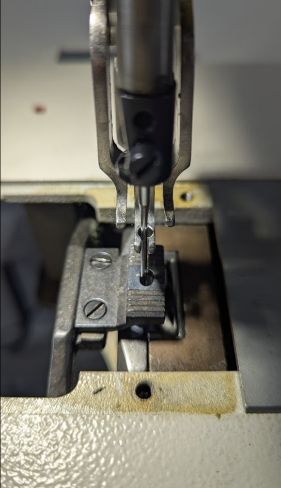

Hello, I bought a second hand HighTex CB243 which I believe is a Juki TNU-243 clone. The machine stiches great, timing seems OK but I keep braking needles again and again... At a point where I am reluctant to use the machine It looks like either feed dog, either needle bar is off and I believe this to be the origin of my braking needle issue... I looked into TNU-243 service manual because machine did not come with any manual and it does not show how to move from left to right the feed dog or the needle bar.
