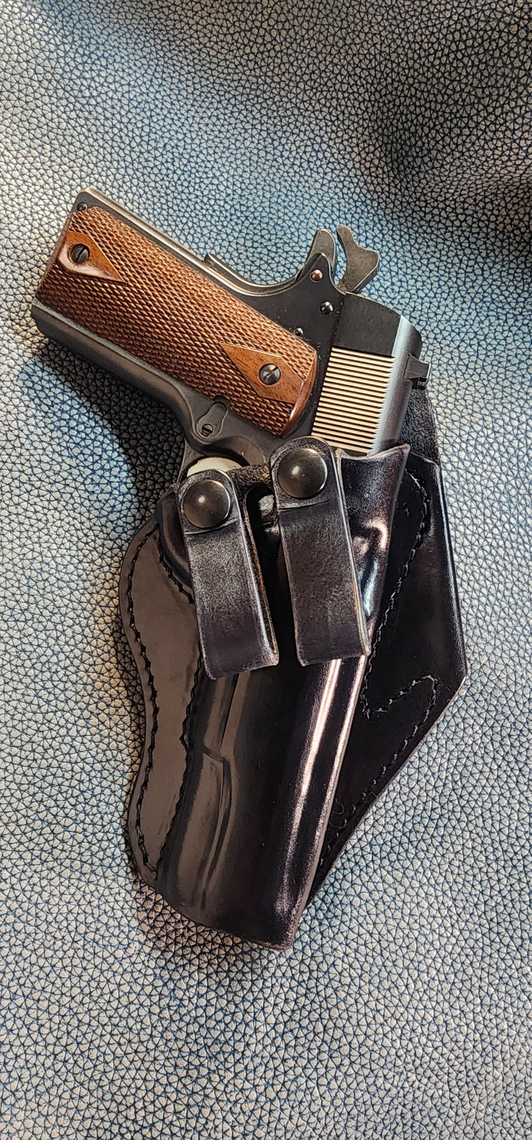

This is an interesting one for me. A unique design I haven't seen before and therefore had to figure out. Lou alessi designed this to be made from one piece of leather. It utilizes an 's' curve that creates an arch along the slide side. This keeps the mouth open and prevents collapse. Really a genius design, and one you seldom see.

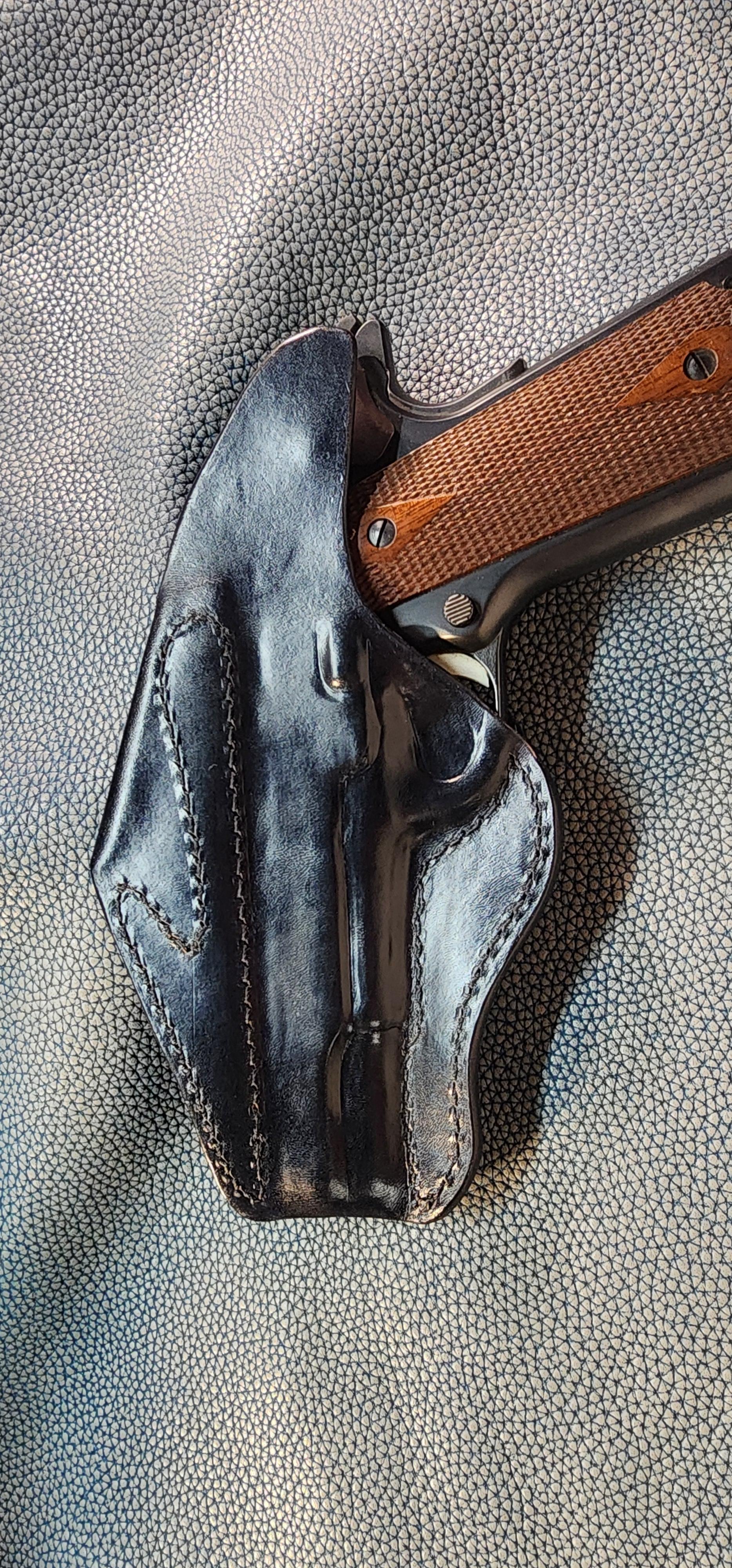

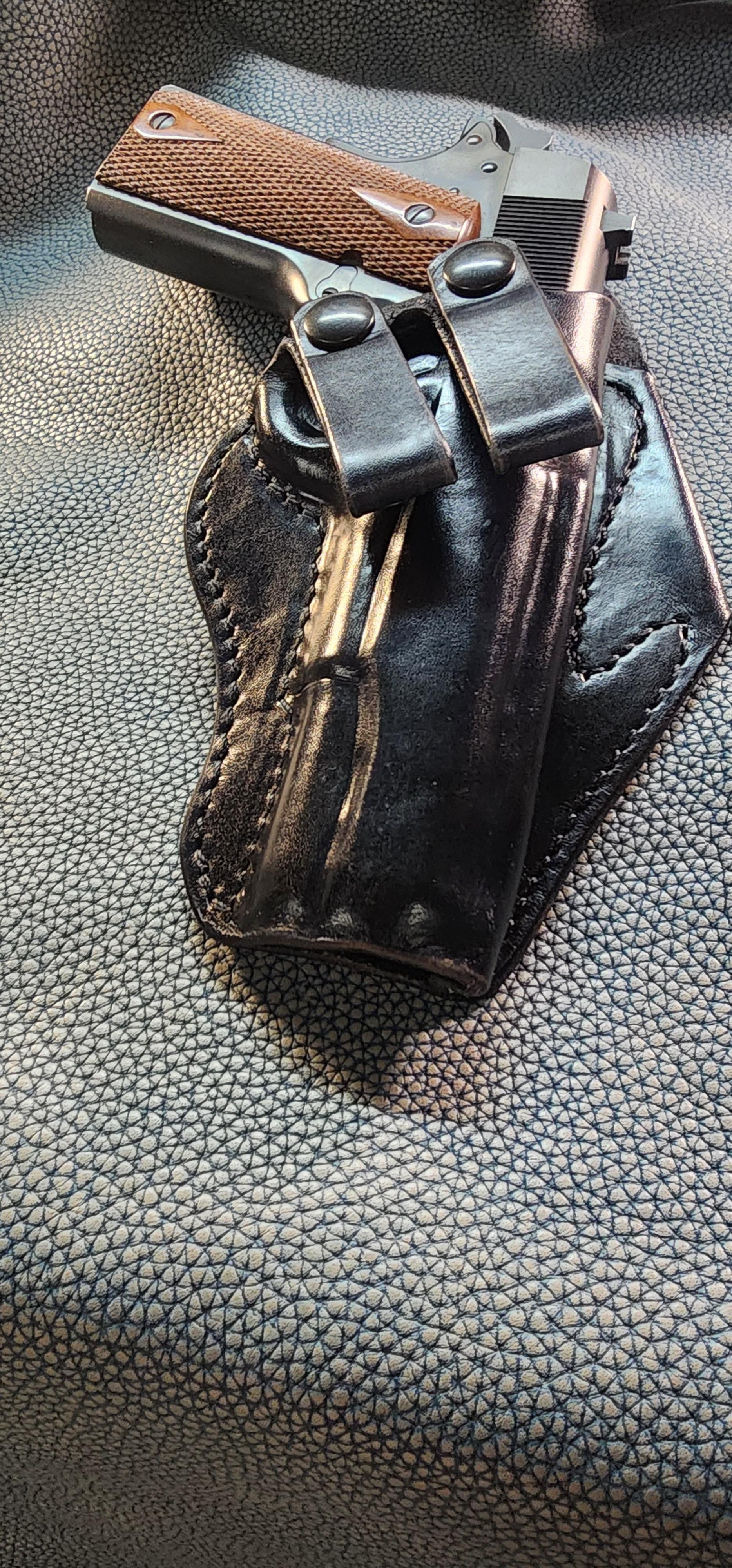

Removing molding marks?
Stetson912 replied to larry1096's topic in Gun Holsters, Rifle Slings and Knife Sheathes
That's looking pretty good. Leather weight is also a factor. I believe jason uses 7/8oz. As for retention, the trigger area and ejection port are the only places retention can be achieved with molding, so focus on those areas. The rest is, as you said, is more for looks -
Jason is a great holster maker. His work is top notch. He does his molding by hand. Molding is an art form in itself. Learn leather has a video of him molding a holster in detail if memory serves. But, In a nutshell; proper casing, smooth tools, and progressive molding. Start with the larger molding tools and work down to finer tools as the leather dries. As it dries it holds more detail but be careful, if you slip thats it, leather is marked. Burnishing in my experience comes as a result of rubbing the leather with something that causes friction, like a wood handle or slicker that isn't completely polished and smooth. Popular molding materials are bone/antler, stainless steel, and smooth plastic. But really anything smooth is your friend. Look up Eric larsen (of hbe leatherworks) youtube. He has a few short videos of holster molding that are useful too. -
Looks a bit chunky to me. I think it's cuz your leather is a bit on the thinner side. The second photo looks like your holes are getting blown out too, which can happen with improper needle feeding or overly large thread or dull stitching chisels. Thicker leather will allow you to seat your stitches better with more tension. I'd try .8mm or .7mm and see how that works for you.
Thanks for the replies, I think I’ll go ahead and get that Big Red just in case. Never underestimate my ability to break things.
