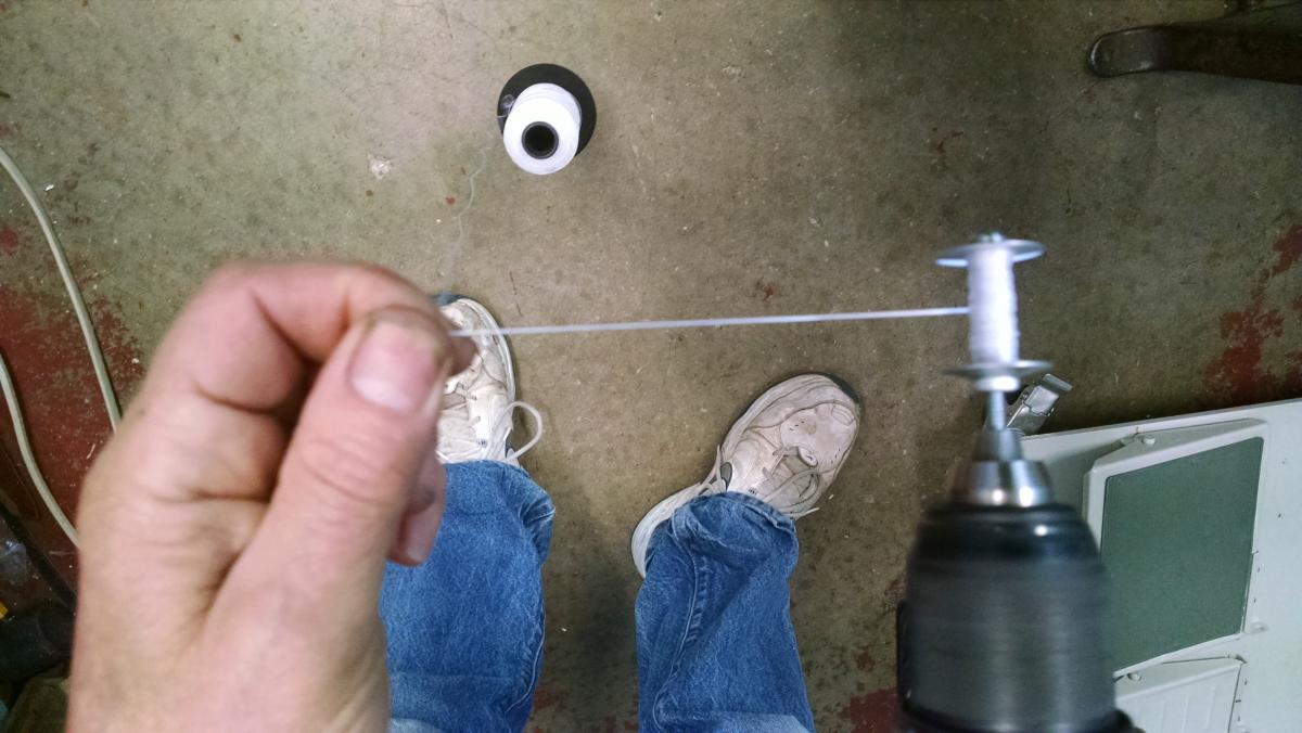

Wow Tinker that looks great! Here's our not so fancy setup a 12-24 screw w/a nut on it about 2&1/2" long and a drill.We often need to wind different sizes so this works great for us.
The old finger pressure thread tension device....How deep is the thread groove in your thumb and finger??
