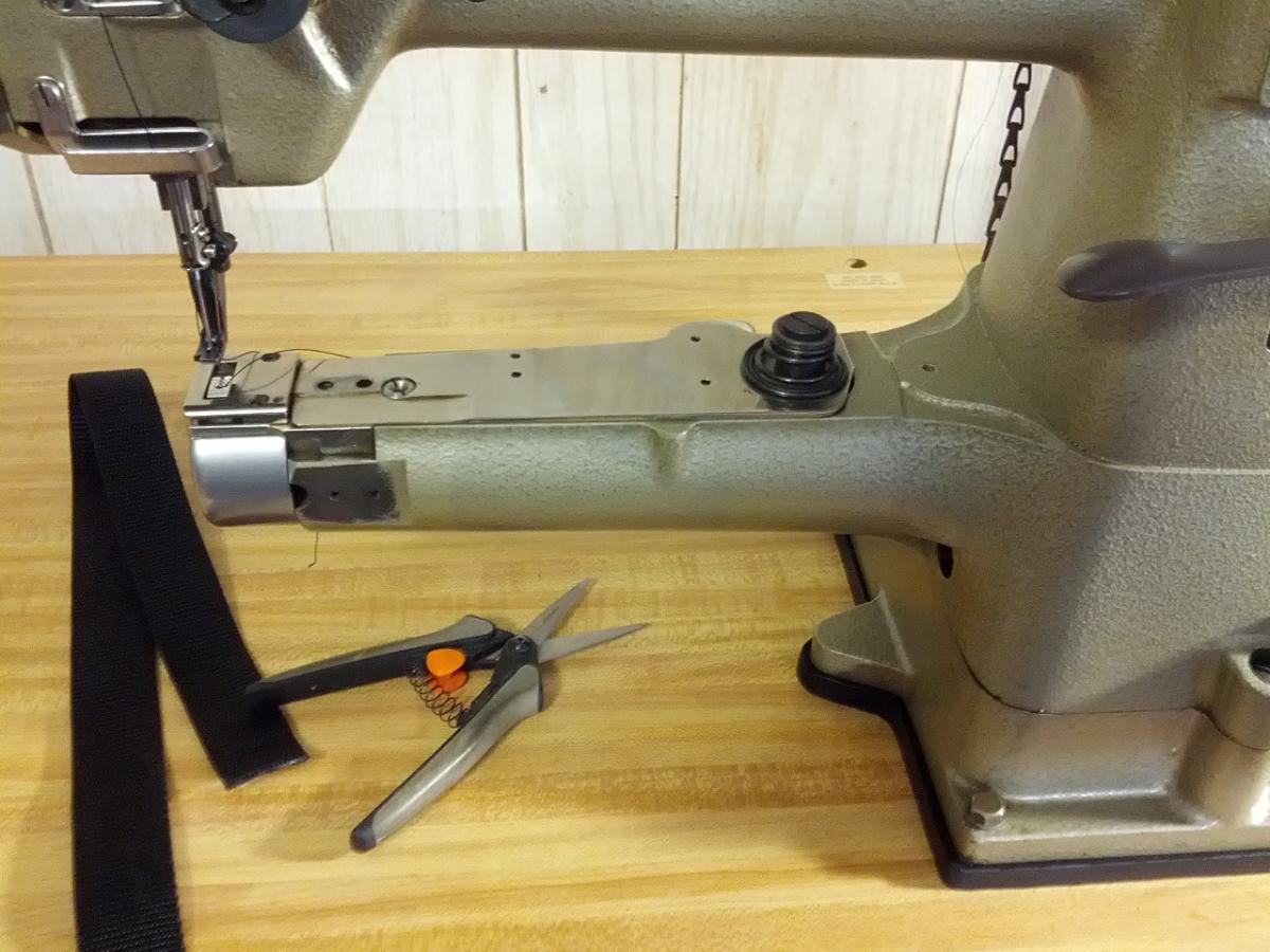

Got it! Or will have when I pick it up this afternoon. :thumbsup: . He wanted $495, I offered $200 (because I didn't really need it) and we agreed on $250. I figure that's a bargain, as all I need to do (hopefully) is replace the feet - plus I'll have an edge binder if I ever need one.

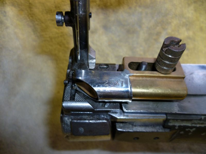

This is the machine. While discussing the possibility of getting replacement feet at my local industrial machine place, he suggested just using the existing feet and slide the binder out of the way. The previous owner said he tried that, and it did work.
Looking at it, however, I reckon I need to make a new plate to replace the long one that has the binder mounted on it (pretty easy, as it's just a flat piece and aluminium should work) and I will also need a new needle plate. A bit trickier, but I should be able to work something out.
It came with a Consew clutch motor, which doesn't look too old, and a quick try before I dismantled it showed that it had pretty good slow speed control (unlike the motor that came with the Singer). I figure that fitting a smaller pulley will give me adequate control without having to resort to a servo motor.
Not at all bad for $250 :) .

This might be a slightly earlier model than mine, or the same - my handwheel is different.
A small pulley on any motor would feel like a big difference in stitching speed control.
Now you are going to need a regular feed dog, throat plate and feet.
Keep those binder parts - you may find buyers for them if you end up not needing them!

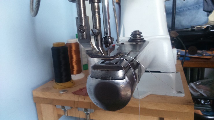

Hi There, looks like we have the same machines. the only difference at first glance is the thread tension unit and possibly the needle bar and the domed shuttle guard cover. (cant see your needle bar) this would be the 335-17B S=fabric setup and 335-17B L=leather setup differences??. your serial nº should be under the thread spool holder plate on top of the machine and on the front rim in front of you. this is the needle plate,feed dog and feet that came with the machine. i suppose they were the originals as they are pfaff made and look quite old. the binder foot and feed dog (non original)have the row of teeth which yours does not have? they could possibly have been ground down as they might have left marks on the leather. just a thuoght?? also it looks like your presser foot tension screw is missing?? or i am going blind jaja!
post-32832-0-40721800-1443874394_thumb.jpost-32832-0-62907000-1443874406_thumb.jpost-32832-0-03294500-1443874418_thumb.jpost-32832-0-81492500-1443874429_thumb.jpost-32832-0-84959500-1443874444_thumb.jpost-32832-0-81029200-1443874453_thumb.j
The non original binder parts are from http://www.kwokhing.com/.
Edited by jimi

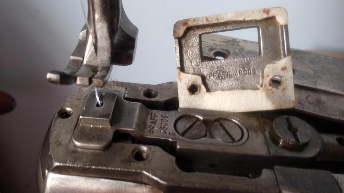

Also check out the Kwok Hing page for the Pfaff 335 for a nice overview of what's available for the Pfaff 335. The regular needle plate and feed dog set come in three sizes - regular, medium and small. The maximum stitch length you can use decreases as the opening in the needle plate gets smaller. Almost any of the presser feet on that page should work for you.
The "normal" non-binder setup would include the 91-158 206-034 needle plate and 91-059 229-04 feed dog set:
post-56402-0-03882600-1443874723_thumb.p
and the KP335W presser feet:
post-56402-0-42185400-1443874730_thumb.p
For the arm cover plate, you may be able to just remove the guide fingers and threaded bits that are attached now to make it flat with nothing sticking up.
The Kwok Hing parts are available from various resellers, or directly from the manufacturer if you get their attention.

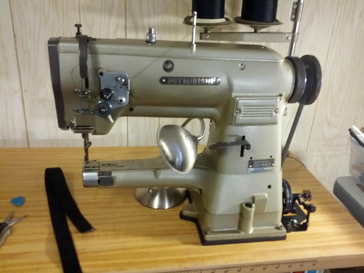

This is all quite interesting to me because of a recent acquisition- a Mitsubishi CU-865-22.... Which looks for all the world like someone grafted a later model Singer 211U156* to to the lower portion of a Pfaff 335, which sort of ties in to the two machines mentioned in the original post.
My machine doesn't seem to have a whole lot of info circulating in the wild, so it makes me wonder how much stuff from these other machines it resembles will interchange.

Sark9, that (lower) cylinder arm definitely appears to be identical to mine, right down to the shape of the cover plate and various screw holes. Your machine looks to be in excellent condition, btw.

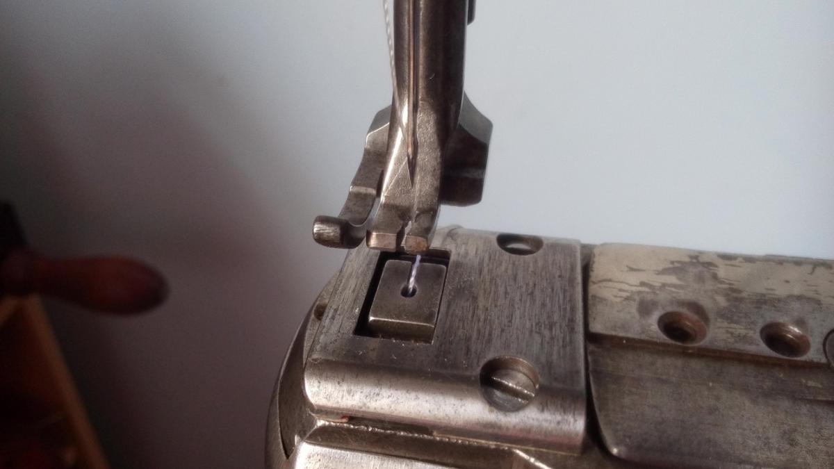

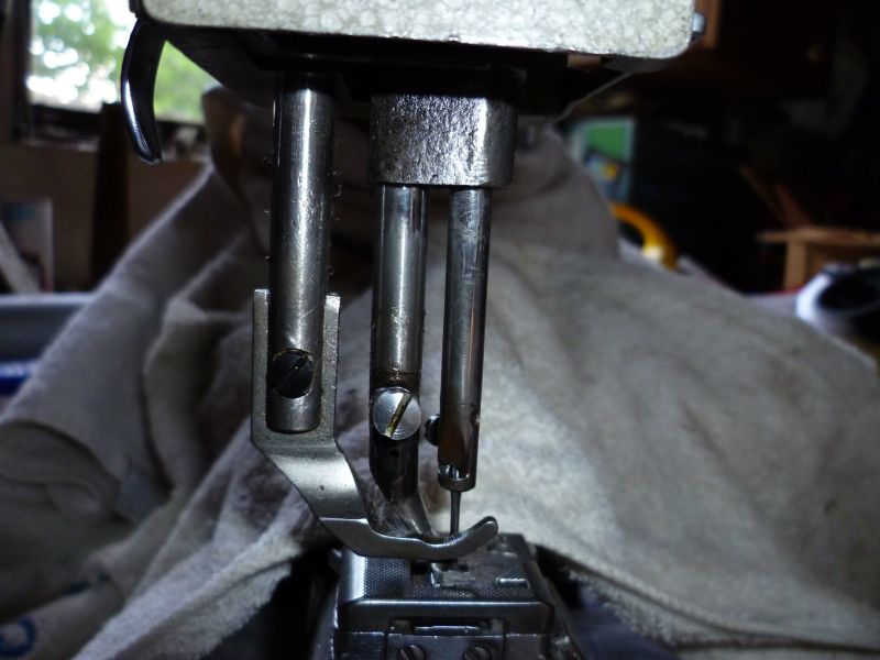

Photo of the needle bar. Does that help?
post-63428-0-83983300-1443911119_thumb.j
Hi dikman , yes your machine is 3 years newer, here is a pdf of the parts for the old class machines, dont know if you have this already?? you can look up the nº of your feed dog to see if it is the same as the one here. if it was not ground off then it should not have the long opening to the left on the needle plate (i think), that would be where the row of teeth move backwards and forwards??335 H3 Subclass Old C.pdf. yes thanks for the pic of the needle bar. what is the diameter of your needle bar? the presser foot tension screw is not metric, so you might have to scrummage around a bit to find one?

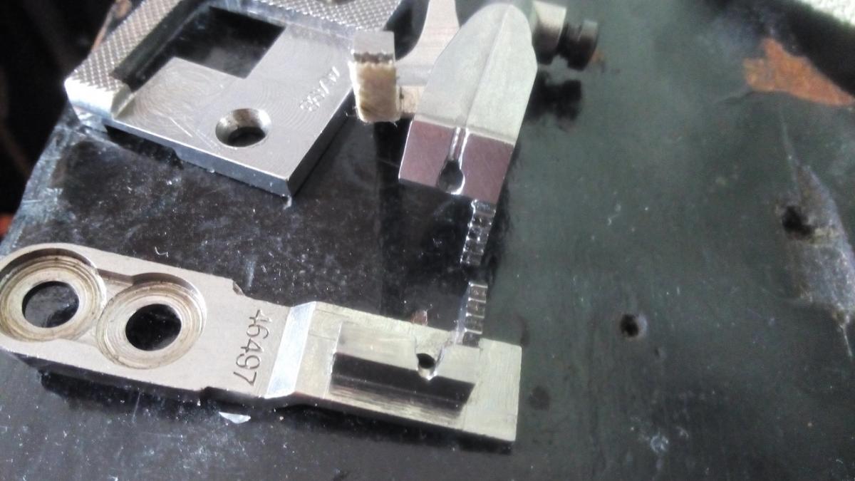

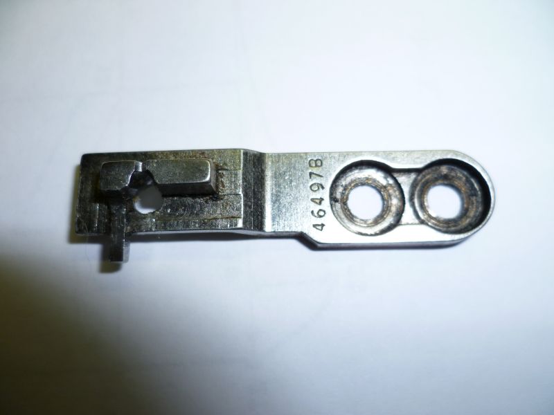

The part numbers on mine are - feed dog 46497B (no Pfaff marking), inner foot Pfaff 5.0B, 4C629 and outer foot Pfaff 8.0 A/B, 40432. I've attached a photo of the feed dog, and looking at it under strong magnification it may have been ground down, although why they would go so far down if they only wanted to remove the teeth I don't know.
post-63428-0-96308700-1444012451_thumb.j
The part no. on the feed dog may mean it's a non-genuine part? The other part no's, while Pfaff, don't appear to line up with their current numbering system.

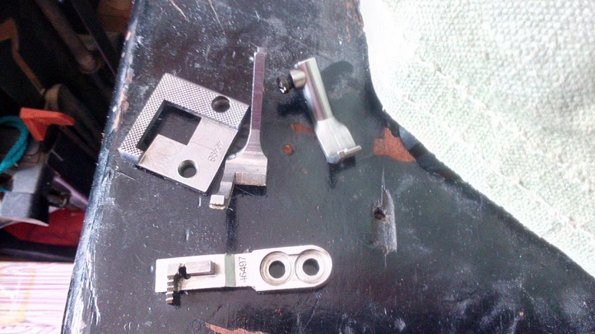

Uwe, thanks for those part numbers, I managed to source the two feet locally (generic,about Aus$28 each, but the guy said I wouldn't want to know the Pfaff price!) but they couldn't help with the feed dog/needle plate. As you suggested, I contacted Kwok Hing directly and they said they would send me an invoice (shipping is dearer than the parts!). I have a feeling that with these parts, and once I get the speed under control, this is going to be a very nice machine to use.
The mailman dropped my Kwok Hing needle plate and feed dog off today. The feed dog didn't quite fit (!), but a bit of work on the belt grinder fixed that. I had already mounted a servo to it, and coupled with an 8" pulley on the head it crawls along nicely. I ran a piece of 1/4" leather through it and it punched the holes without any effort, so figured I'd better try some stitching. I loaded some #69 white thread on the bobbin and ran some brown #69 through the needle. The machine came with a size 21 fabric needle, as it had been used, with #69 thread, for binding some sort of nylon/cordura material so I just used that needle. Max stitch length, one layer of 9 oz veg and the stitches looked great. I shortened the stitch length and ran it through and again it looked good. Next thing was to double the thickness - and this was where I came undone! The second scrap piece I used tapered down to a narrow end, it started stitching well and then "twang", one busted needle! (I'm getting quite good at breaking needles).
