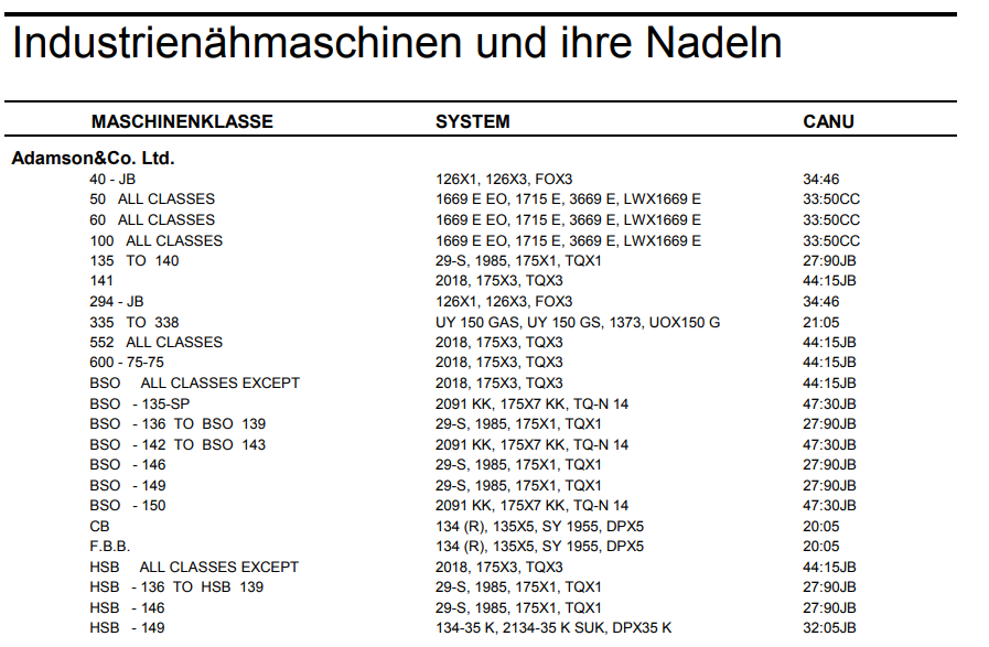

Well, while browsing on this here web site in articles posted long time ago (nigh on 10 years) - I found a 143 page needle chart that Con had uploaded. And guess what - the first company on the list was Adamson - and they do list the BSO models as well, so it the same company. Unfortunately I could not find any models on Ebay.UK other than the Button Sew On machines. -

Found this chart on the internet a while ago - had lost it amongst my bookmarked pages. For leather sewing machines, look under : Arm- und Säulenmaschinen / Sattlernähmaschinen Also good for identifying unknown needles cause it has exact needle measurements - which for old needles are often hard to obtain. https://www.naehmaschine-antik.de/technik-nadeln.html#leather-nm Greetings Hans
