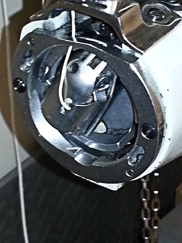

It sounds like your shuttle driver gear is out of sync with the needle bar. There are only two places that can adjust this relationship on a patcher. One is the eccentric screw connecting a rod inside the body to the rack gears. It is accessed through a big hole on the lower front of the main body. Turning the large flat slotted screw moves the shuttle. The second place is underneath, where the rack gears turn the shuttle gear. You may need to change the position of the shuttle gear, or maybe even the passive rack gear.
