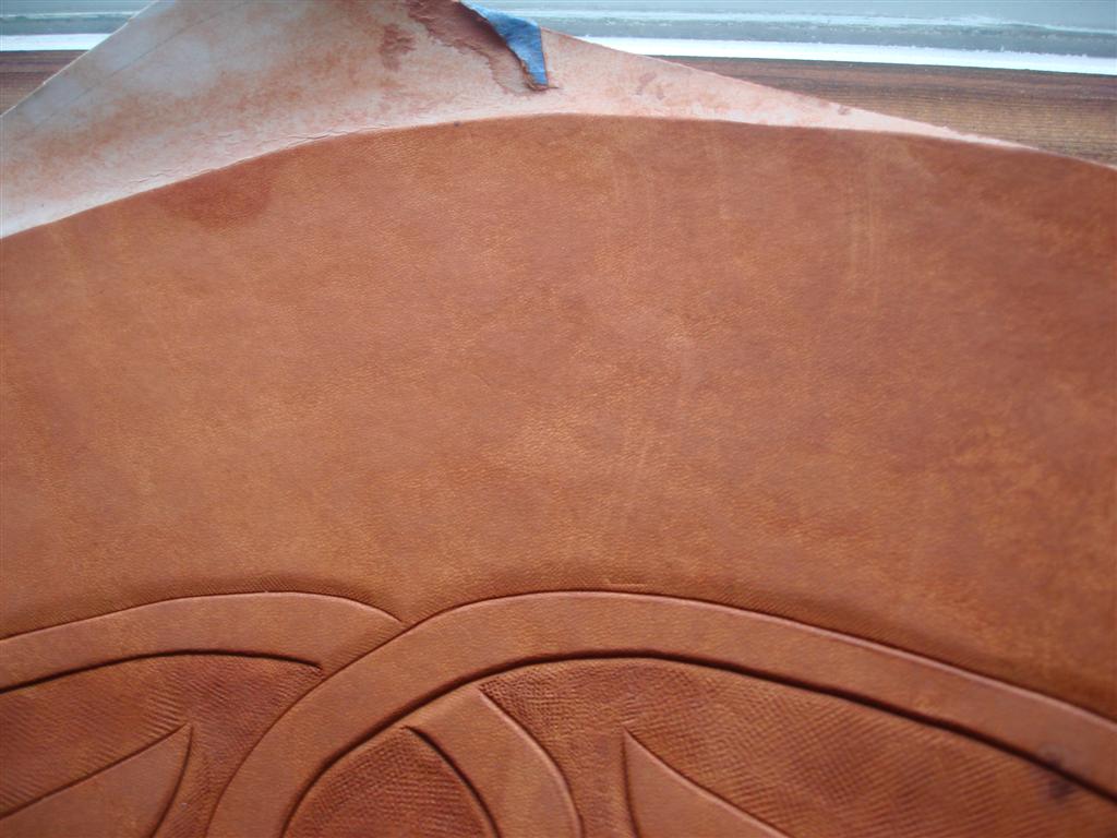

Thanks Hilly. I am starting to come to the same conclusion about the leather. As far as saving this piece I might try a darker brown first, you can always make it black later if it doesn't work out! ) -
	Here I am again with another project gone bad. I'm afraid this piece might get the "total Black" treatment as it now looks bad and is not worth much in its present condition. I've attached the before and after pics. They dye did not seem to soak into the leather in some places, causing a very light blotchy areas, even after multiple water diluted applications (recommended by Tandy class to get even coverage). Here is what I did and the materials used: - Tooled leather (Tandy's #2 stuff....) - Cleaned with Oxalic Acid solution and let dry several hours. - Dyed with Eco Flo Tan Canyon dye, diluted 5:1 (about 4-5 applications of dye, trying to get it to even out...) - Dyed background with Tan Canyon 3:1 solution (This didn't seem to come out too well...) Any ideas? I have some Angelus Dye and some Herman Oak being shipped from Springfield leather as we speak. I'm hoping I can blame it on the leather and dye, but I'd like to identify any technique problems before ruining another piece! I did want to add that after looking at this post that one of the "before" pictures has a discoloration in the leather that was picked up by the camera flash. Are there artifacts in the leather that cause it to dye unevenly? Should I just wait and try the Herman Oak and not look back? Thanks.

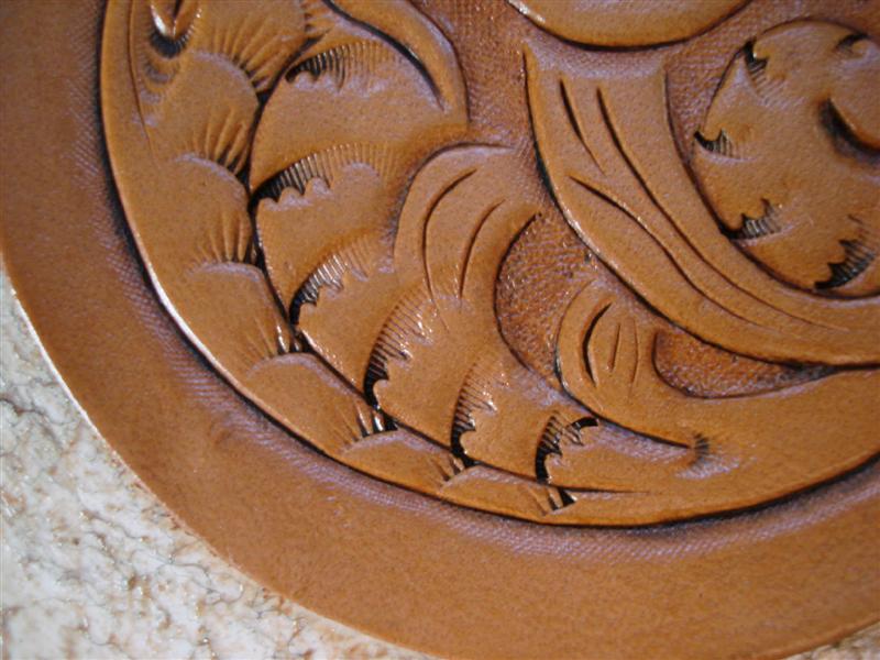

	Hello, I did one heavy coat with the Bee Natural RTC on both items. I think I am going to try and give it two heavy coats next time wtih some drying time in between. It might be like polyurethane on wood, the first coat soaks right in and you need a second coat to go on top of the first to back it up and get whatever areas it might have soaked in too deeply. Thanks for the tips guys, and what to look for. ~Ken
	Hello, I used the same technique on two different pieces and got very different results. I was wondering if anyone could enlighten me on what I'm doing wrong. The only thing different is that the bookmark piece did not have a base die added, it was left natural. Here is my technique, each step allows drying of at least 8 hours before the next: - Dye with Echo Flo Water based die, diluted for even application and desired color. - Apply two medium heavy coats of Bee Natural Saddle oil. - Apply Bee Natural RTC antique resist. - Apply Echo Flo "Gel Antique" (Med Brown) and remove immediately. - Apply Bee Natural RTC resist to seal in the antique. As you can see from the pics, the Coaster is decent looking, but the bookmark is trashed. The antique somehow got under the resist or died the resist itself, I'm not sure which. I might try stripping the coating with deglazer and dying it something dark, but its probably ruined. Should I just buy the Fiebings black antique paste and ditch the Eco Flo antique to get that "sheridan" antique look, or am I doing something wrong?

	Hello, I don't mean to sound like a commercial for them, but I found other posts about Bee Natural products. I just bought their RTC sealer/finish and their saddle oil. It looks like the process if very similar and they have a video on their website: (All steps have drying time after, usually at least 5 hours) - Apply any die you want as a base - Oil with saddle oil - Apply RTC finish - Antique - Apply RTC finish I'm hoping this works because I like the idea of using as little products as possible. I'll report my experience. (I'm waiting for some dye to dry right now). ~Ken
	Hello, I am not an expert, but in my experience you need to die your leather (unless you want the natural look) and then seal it really good before using the eco flo gel antiques. From what I understand the traditional way to do "Sheridan" antique is to dye, oil, sealer/resist, antique, and seal/resist again. I'm in the middle of doing some experiments on some circle cutouts to test Bee Natural saddle oil and RTC finish over Eco Flo Dye. Unfortunately you have to wait a long time in between your experiments to let everything dry! I've used the Eco Flo "Super Sheen" as a resist successfully, but I'm not sure I'd use it for outdoor gear. I think you are better off using a natural oil/wax based finish that will let some oils penetrate the leather for years of upkeep. The Eco flo super shene acts like an acrylic paint and (I'm guessing) will resist any additional oil later on. When I have successfully used the gel antique has been with practice pieces (Keychains, drink coasters, etc). I've used dye, let it dry for 8 hours or so, applied super shene liberally, let that dry for 8 hours or so, then apply antique gel liberally. Usually a damp cloth is needed to wipe away all the gel and help it penetrate the tooling stamps/cuts. Let this dry for several hours and then hit it with the super shene again to seal in the antique. ~Ken
