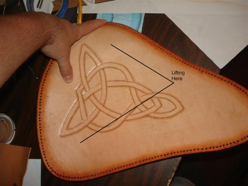

  4. Here is my first bike seat ever (not to mention my second carving experience). Some things I am happy with, others I am really disappointed about. Hopefully someone will like it enough to buy it to cover materials for the next one. I think the lacing came out pretty good (uneven in spots) but I know I can improve this. The biggest let downs for me are the wrinkles in the seat top, and the nicks and scratches in the top that soak up the dye to create the little pock marks seen in the photos. I'd also think I should have backgrounded the designs, and used more even beveling. All I can say is I have my mind set to only buy high quality leather from now on! I had bought this leather before beginning the hobby and it was a clearance of low grade import leather. I think the money I saved was traded by misery in casing, tooling, and dyeing! Any other critique? I appreciate any advice or help offered. ~Ken

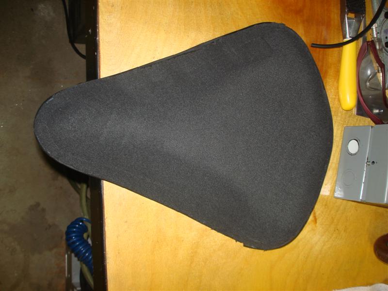

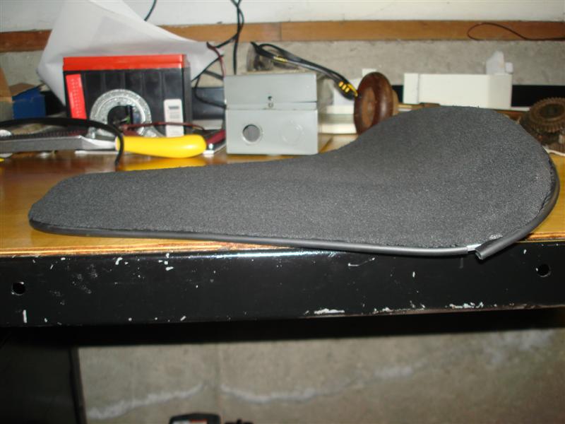

  10. Hello, First of all, I'm an amateur at leatherworking in general, so go easy! ) I am in the process of making my first motorcycle seat covering. The seat pan and foam radiuses upward on the back (Somewhat typical "solo" spring style seat), and when I pull the top down over the sides the middle of my leather is wanting to pucker up toward the middle at the start of the radius back piece. Should I do some wet forming before I start lacing? Should I wet the leather center while lacing it? (being careful not to wet the lacing holes) Or should I lace the thing dry and then give it a good wet molding in place by putting some foam on top of it with generous weights? I started dyeing the project, but on the top piece I only went around the edges in case I had to apply some water to stretch the edges out some. Thank you in Advance, ~Ken
