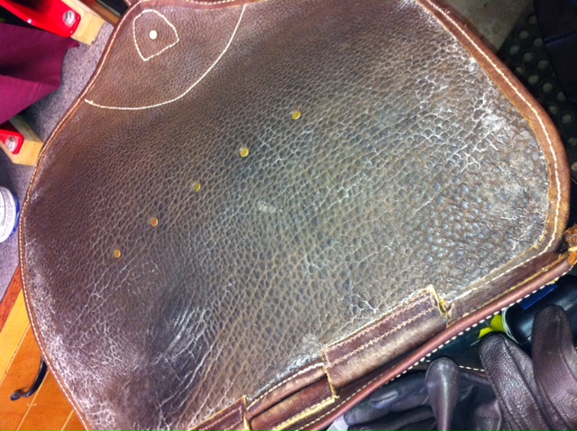

Have a question about some Bison leather I have been using to make gun cases and shell bags. Once completed I apply 1 coat of neets foot oil and then several days later 1 coat of Montana pitch blend ( beeswax, pine tar pitch and mink oil). Both oils penetrate very well and absorb into the bison. I have a guy I have made a case for and after a while ( months ) the bison will develope a whitish material on it( attached photo). I have looked at the hide I took it from and there is no whitish color to it. I have asked if the case ever got wet to see if this is mold- havnt heard back but I suspect the case has not gotten wet ( the bison was on the inside of the lid of the case and the rest of the outside of the case-made from latigo- was treated the same way and has no whitish material on it). This occured last fall and I had him allpy some oil( I think he used neets foot oil - but trying to find out- and said it disappeared immediately, but now its back 4-5 months later. I also wondered if the case has been kept in a cold place which would cause wax to get thick and crystalize- be lives in up state NY I suspect its cystalization of either the bees wax or the pine tar pitch. Any one ever seen this??? Why only on the Bison and not on the Latigo leather ??? Is there any solution for this??? Im going to post this in several places hoping someone has an answer for me Thanks for any insight RMR

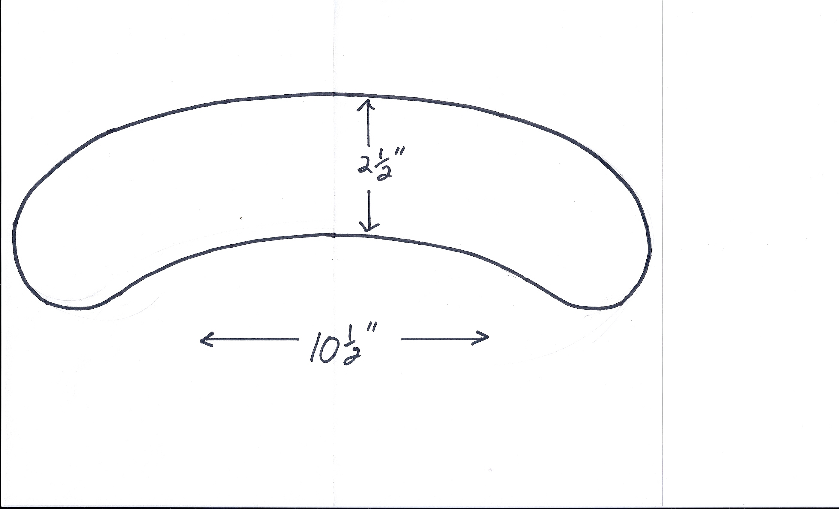

Tim I have a second shape that I might also want - if you are up for it Let me know. I can mail or fax original tracings I have made of both shapes . I will need all the edges rounded off, and would prefer this made of 1/2-3/4 material- Im thinking the thicker the better. What do you think they would run? Thanks RMR
I will try and draw a picture and post it latter tonight RMR
Tim My best guess watching the video is its about 11-12" long, probably about 2-3 " wide and about 1/2-3/4 thick. It is shaped somewhat like a bananna or a boomerang with a gentle convex curve on the front edge and a has a concave back edge, the two sides are also rounded with sightly differrent radiuses (sp??) - it looks to me like all 4 edges can be used for differrent places on a saddle. All the edges are rounded off I can certainly draw what it looks like RMR
Does anyone know of somone who makes an acrylic leather slick for seat work - like Jermiah Watt uses on his video?? If not is there anyone else out there that would be interested in one? I found a glass store here in Dallas that will make them from 1/2-5/8" thick plexiglass if they are provided a shape to go by- which will be easy to do. I suspect there will be a minimum order reqiured to have them order the material. Thanks RMR
