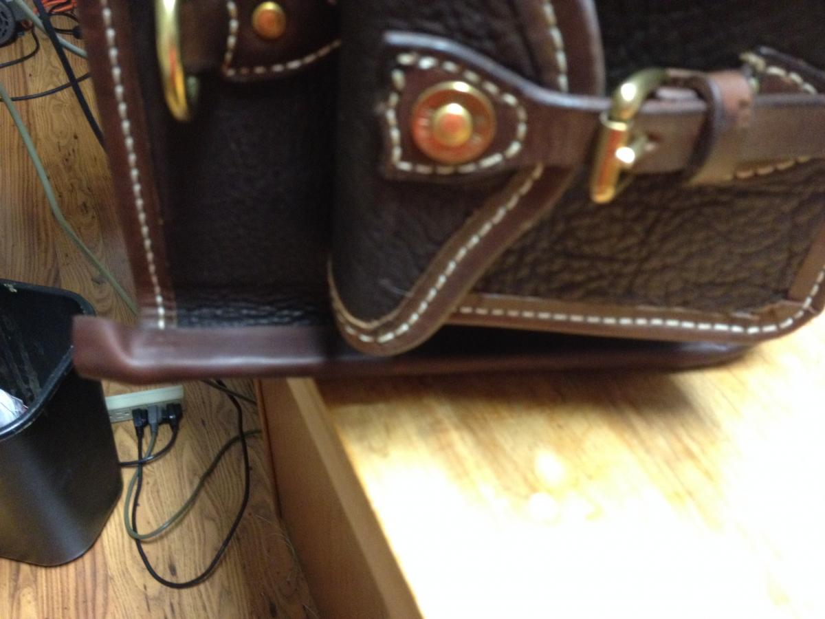

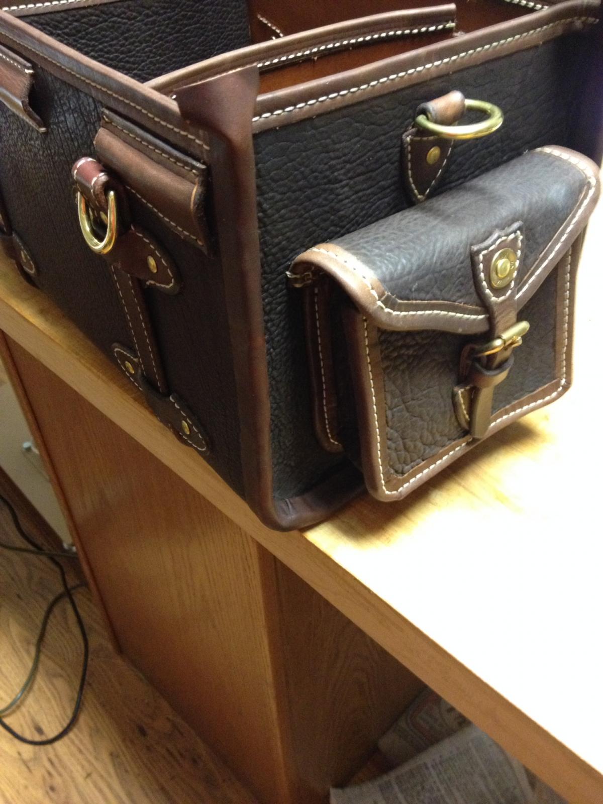

Just finished this range bag to hold shooting accessories. Made from bison and lined with light weight veg tan RMR
