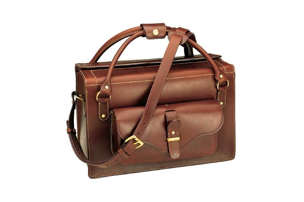

Im making a case that has a top that has a retangular section of brass that maintaines the form of the lid- but will allow each half of the lid to open straight up- I call it a spring lid hardware. I have attached a photo of the lid- unfortunately I dont have a picture of the actual hardware. Does anyone know what the actual name of this harware is - and even better- where to purchase it Thanks Bob R

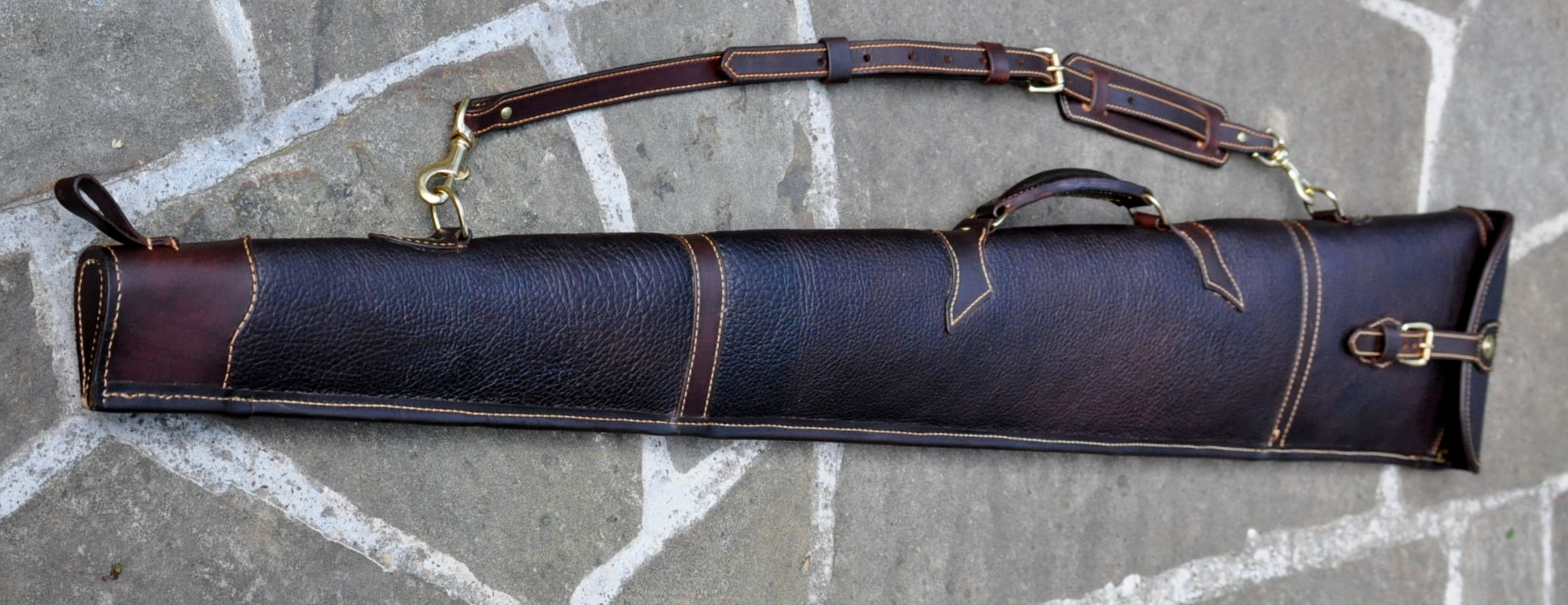

hi I have been doing leather working for about seven years. I have primarily made shot gun cases, shell holders, accessory bags and fly-rod cases. So, I have most of the basic leather working tools as well as a cobra 4 sewing machine. I will attach some pictures of a couple of my projects. What I am trying to decide is do I have the technical abilities and experience to attempt a saddle. My 10 year old daughter who has been interested in horseback riding for several years and is currently taking lessons, told me this morning that for her next birthday or from Santa next Christmas, she wanted her own saddle (as well as a horse to go with it, as I am pretty sure she is not going to get). I know I could just go out and buy one and be done with it - but the sentimental part of me says I might be able to make her one that would be more meaningful to her - something that I hope she would keep and cherish long after I am gone even if she outgrows it and it sits in her room. The queston I have is how hard is it to make a saddle. This is something that I know absolutely nothing about. I have always looked at these on this site and have been amazed at the workmanship and frankly it is just scared me and I have just stayed away from contemplating this kind of project. So how difficult is it going to be to make a basic saddle or should I rephrase this and say what kind of learning curve am I going to be looking at? I know there will be some necessity to buy additional equipment (I am always a believer "he would die with the most toys wins"). So what I am looking for is an honest opinion whether based on teh type of projects that I have currently done, is it realistic for me to tackle a saddle at this time or am I way over my head and I need to tackle other projects to advance my leather-working skills before trying to tackle a saddle. Please be honest, I have thick skin. If this is feasible, I would appreciate any references such as recommendations on books, DVDs, equipment, etc. Thank you. Bob R.
