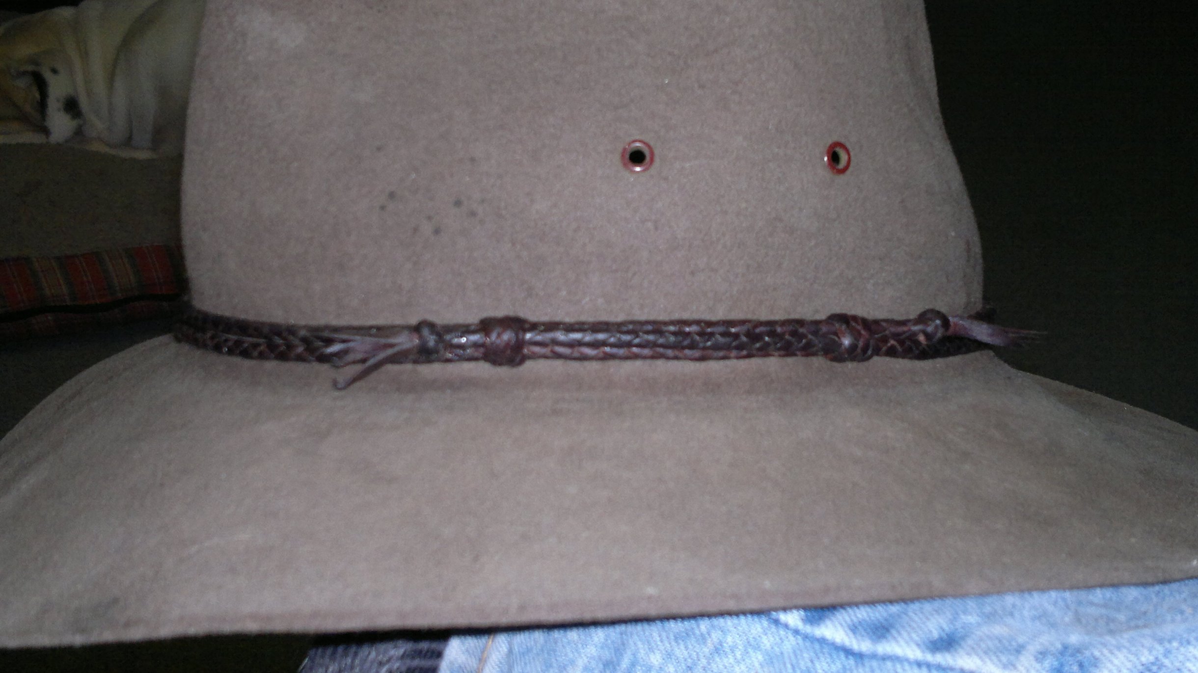

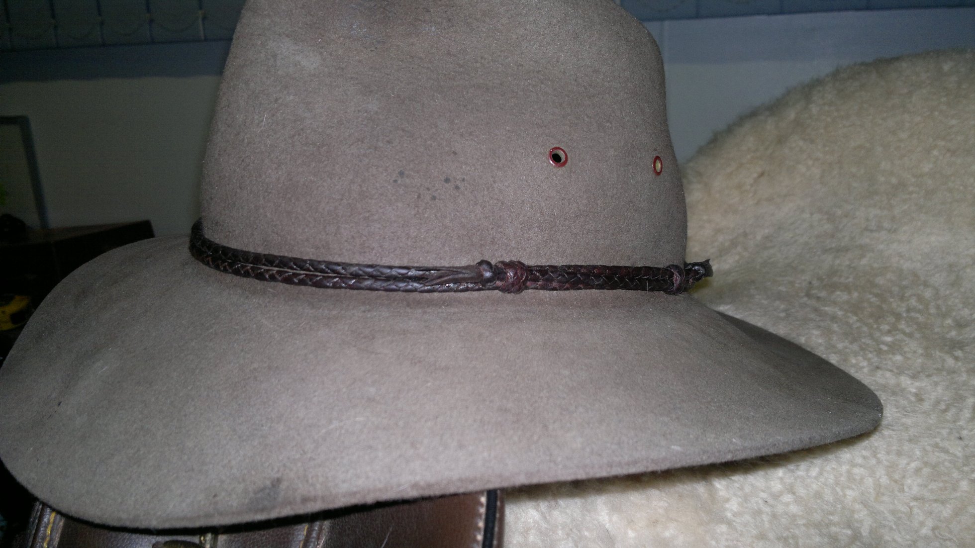

    Here are a few pics I took of a hat band I made from the lace i cut from the video thats I posted on LWN Just a simply 4palit wraped twice finished of with a crown knot and a few 6bite turkheads holding it all together . Photos were taken on the phone , I have resized them but not quite enough ,,, for those that can not see them just go to zoom on your compute and cut it back to 50% !!!!!! Thanks for looking Cheers Bevan www.bwrwhips.com
