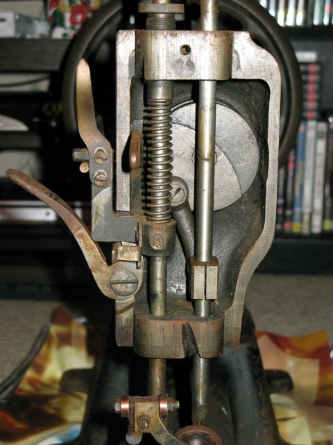

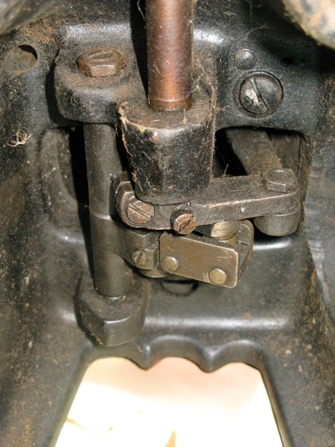

Hi Bruce, Thanks for that. I've actually started taking the machine apart now mostly to understand how it works since I've never had one before. It's a good thing I did because parts of it are quite worn and one of the castings is cracked. The four screws on the top are just structural. The adjustment seems to be done on the lower roller from underneath. It looks like the reason it won't adjust down to zero is because of wear in the cams that set the height of the upper roller, so I'm going to have to shim it somehow. I'm still curious about the maker. It's odd to find a company that has no hits on google.

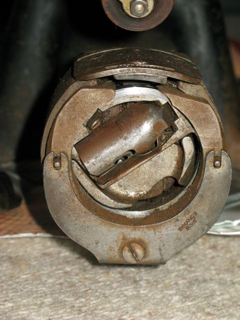

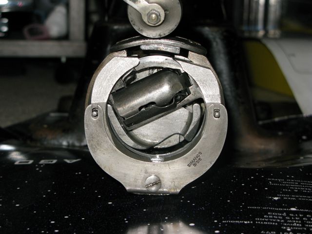

Another question about this machine which I'll stick here rather than start a new topic on - I'm wondering if I'm missing a bit of the shuttle carrier. There are two screw holes in it that were empty when I got the machine and I can't figure out what they're for. The shuttle doesn't seem to be the part #98608 "Shuttle Driver and Feed Raising Cam" listed in the parts manual from parts.singerco.com, but that manual also talks about the part only being suitable for the shuttle #98608 "not with the old style Shuttles". Given that my machine is a 1915 model, I'm wondering if what I've got is the "old style" shuttle driver and shuttle it mentions, presumably meaning I'll have to replace both parts if I want to replace the shuttle Here are some pictures showing the screw holes: I can't see how these could be for grub screws because there doesn't seem to be an appropriate bearing surface on the shuttle hook for them to mate with. Is there a part that goes on here that I'm missing? Thanks.

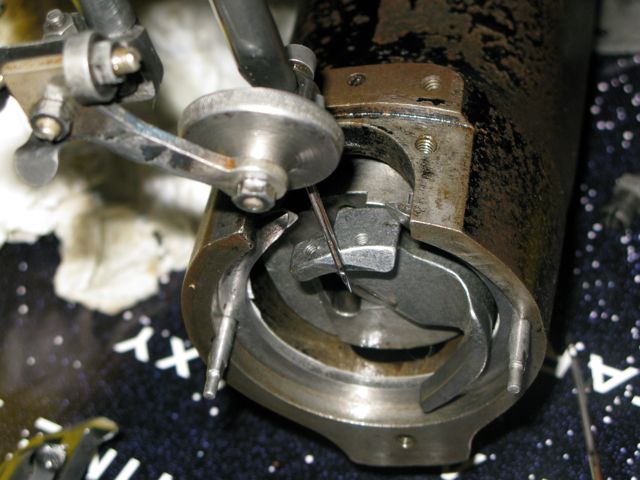

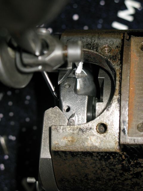

Hi all, I'm working on a 45K25 I picked up recently for NZ$200. It's been in someones garage for the last several years and looks like it's had some slightly 'interesting' work done on it in the past. A lot of the screws and bolt heads are a bit damaged and the grub screw holding the hand wheel on is totally wrecked and needs grinding out with a dremel. The connecting rod that actuates the shuttle was disconnected when I got it and the machine didn't turn over cleanly when I reconnected it. Turns out this is because there was a grub screw in it that was way too long and was grinding on an adjacent part as it osscilated. The main drive shaft and cams etc seem tight, there's no slop in the needle bar or anything so I left those bits alone. I've stripped the bottom half of the machine and cleaned it up. Here are some before/after shots: Now it's pretty much all back together and it turns over smoothly. It needs a new feed dog and needle plate at least, and I want to get a wax pot for it, but I want to make sure it's going to sew before I start forking out for more parts for it. I think the timing is fixed on this machine so I've adjusted the needle bar height but I'm concerned that there seems to be quite a bit of slop in the shuttle. Forward to back is fairly tight but there's quite a bit of rotational slop in the shuttle. It picks up the top thread Ok, but it seems to catch let the loop go cleanly. I'm not sure if this is a timing issue where the shuttle is starting the anticlockwise oscilation before the thread take-up has started or if it's because the shuttle is munted. Is a bit of rotational slop normal for this type of machine, or do I need a new shuttle and/or shuttle carrier? I'm also wondering if the clones of this machine like the Techsew GA-5 are sufficiently parts-compatible that I could use screws for one of those to replace some of the damaged ones on my machine. I dont' really know what thread types the 45K is using, but being a 1905 british-made machine it seems likely that they're some flavour of imperial but I have no idea what. Does anyone know if the GA-5 machine needle plates and feed dogs will go onto an original 45K25 as well? Thanks in advance.

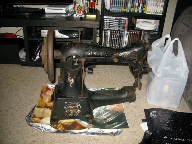

Hi all, I've bought an old 45k21 pretty cheap. It's complete, but not in the best condition. One major problem with it is that the linkage between the main crankshaft and the shuttle carrier bar had been disconnected when I got it. The parts are there, but when I reconnect them something is sticking pretty badly at some point in the rotation of the handwheel. I'm stripping the machine to clean the rust and gunk off and check the parts for wear etc. I'm taking lots of photographs and notes as I go but because it wasn't fully assembled and running when I got it I have very little confidence that I can get it back together with the timing correct. I know where all the bits go etc and I'm keeping an extensive photographic record of the disassembly so getting it back together intially isn't a problem but how do I get everything back into alignment again? Assuming a pile of parts and knowledge of roughly how they go together but not the exact rotational relationship between each part on the shaft etc is there a procedure to follow for getting a machine like this running again? Thanks.
