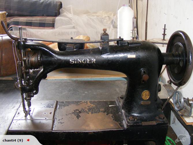

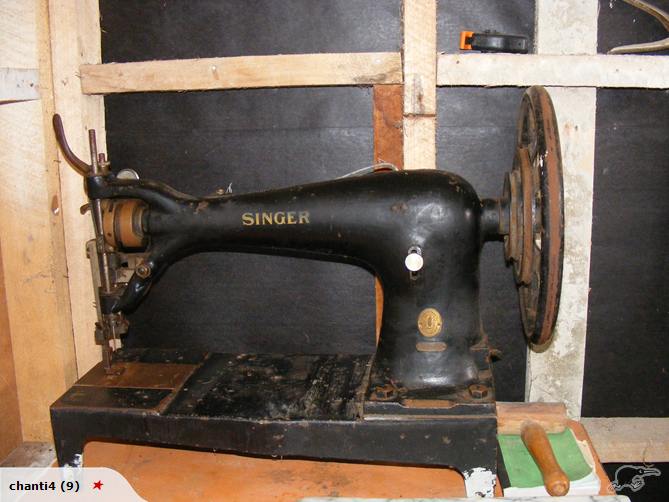

Hi all, Someone up north of me is trying to sell a couple of 7-class Singers, a 7-9 and a 7-5. Neither looks to be in great condition based on the photos but they're trying to get a lot more than I think they're worth for them. I'm keen to make an offer on one or both of them but I'm wondering if my gut instinct of what to offer is actually reasonable. I'd be very interested to hear what more experienced minds than mine think a reasonable offer for these would be. The 7-5 is a head only and has a broken tension spring. The 7-9 is on a table, which I don't particularly want, and apparently goes. Whether this means it actually sews or it turns over and doesn't have any obviously broken bits I don't know. The 7-5 The 7-9 Thanks.
Hi Angelo, There are a few places still selling needles, but they're expensive. I just laid in at vast cost what I hope is a lifetime's supply of the sizes I could get my hands on (15 x #5 & #6, 5x #8) but I can't find an even vaguely affordable source of #7 needles, which seem to be the most commonly used, and therefore now hardest to find, size. When you get to working on your machine check that the point of the shuttle is good and sharp, even if everything else is right it won't sew if it isn't. If you need manuals let me know. If you need parts get in touch with Henry Veenhoven. He's rebuilt more of these machines that most of us'll see in a lifetime.
