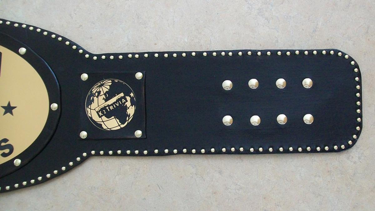

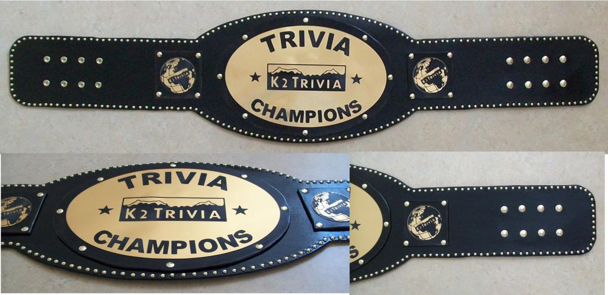

I had someone ask me to make them a Championship Belt with their logo on it.......so I figured, what the heck, why not. It LOOKS simple enough....... The finished belt is 50" wide and 12" tall in the middle. I just used Marine Corp black dye and resolene as the finish. I made three gold metallic plastic pieces with the logo and attached them to the leather with a pretty strong 3M adhesive (the belt is for show, it's not meant to be worn daily). I designed it by myself based upon the belts other people make/sell. And I drew the pattern by myself. It didn't print out very correctly, but I was able to get everything liked up correctly after printing it off a few times. Cutting it out smoothly was a challenge, and I only made a few mistakes. The edge beveling didn't come out very well. Staining wasn't very difficult since it was black, but the resolene finish didn't come out very well. The eight snaps were easy to do, and I was happy that they I was able to get them all lined up correctly. The biggest pain was the studs outlining the piece......they took FOREVER to put in.....there are over 200. But overall, I was happy with how it came out. Let me know what you think. Here are some pictures:

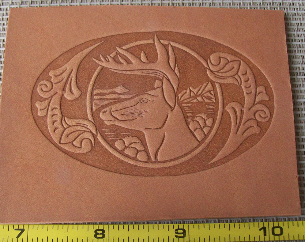

I just finished making this new design of a buck deer head with antlers in front of a mountain scene. Although the size is approximately 3.25" wide, it can be made any size. Here is the listing in my shop: https://www.etsy.com/listing/129031372/deer-scene-number-220-leather-embossing?ref=shop_home_active
Just finished making a 9" wide embossing plate of a pair of wings for one of my customers.....unfortunately, I don't have a press big enough to use it!!! That's why some impressions were on the bottom.

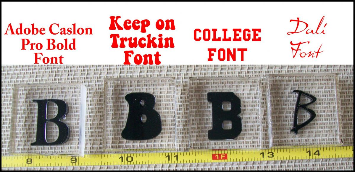

For some reason I thought small stamp sets were readily available......but I guess just not under 1/4" tall. Smaller than 1/4" is not problem......just not with this technique. Here is one of my free Made in the USA stamps that is only 0.5" wide......the height is .08" or about 5/64". -

Sounds good.......if you need font ideas, you can go to a website like Dafont.com and type in your text and see what it looks like in thousands of different fonts. -

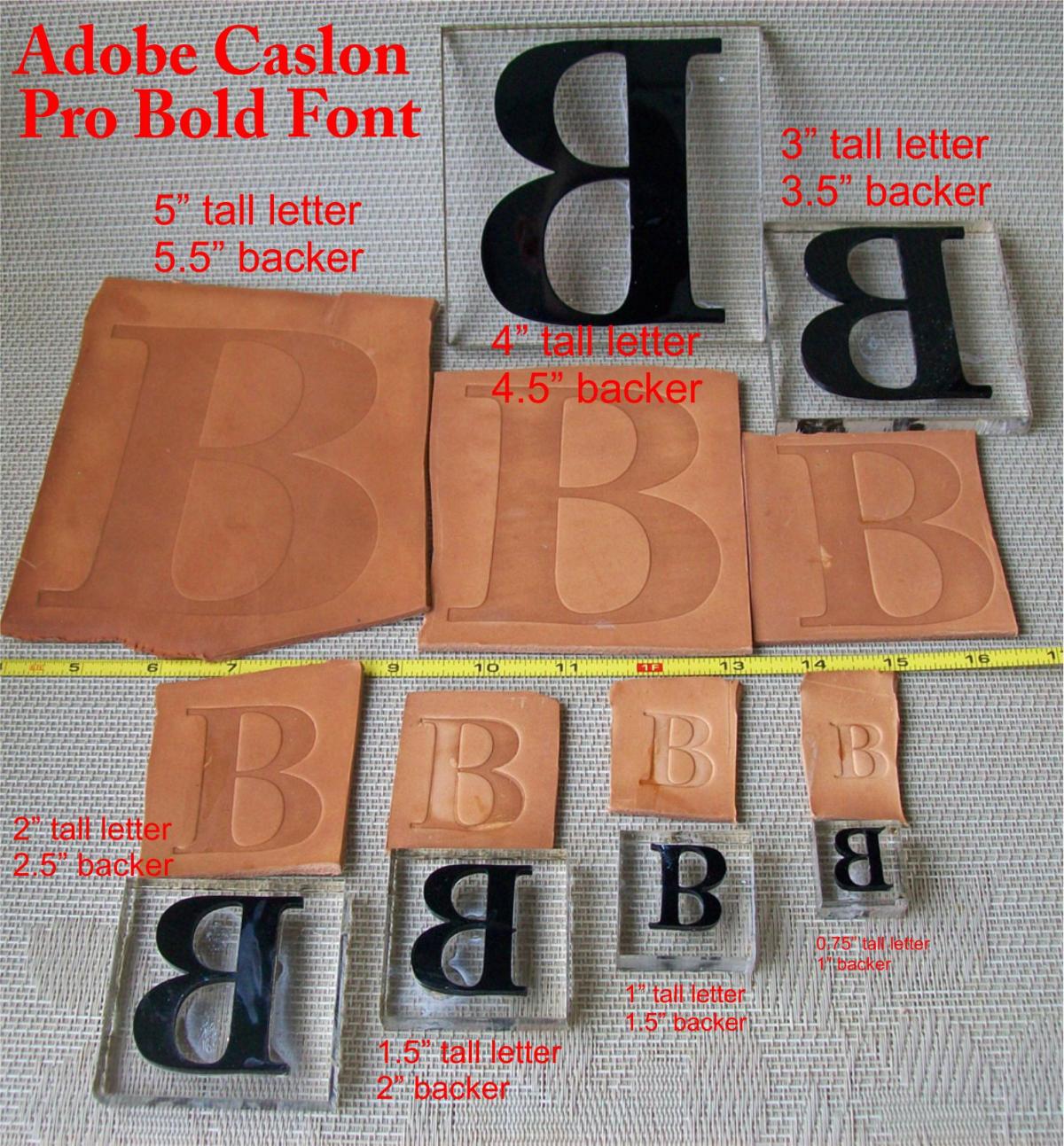

I just added some new listings to my shop for low cost acrylic stamp sets. Here is a link to one of the listings: https://www.etsy.com/listing/128032078/alphabet-stamp-sets-any-font-12-or-34?ref=shop_home_active And here are a few pictures showing various sizes and fonts. If you have any questions, please feel free to send an e-mail to me at: CustomMadeStuff@gmail.com
