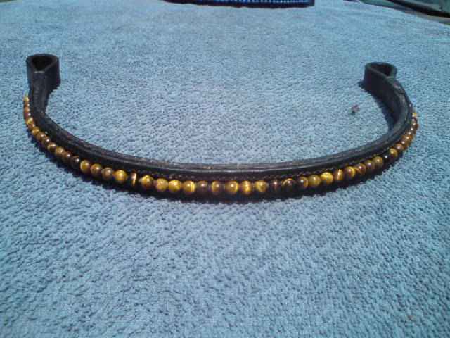

  5. I had to make one of these this week as a present for someone in the UK. The leather is 3-4mm bridle , 3/4" wide and the stones are real 8mm tigers eye.
