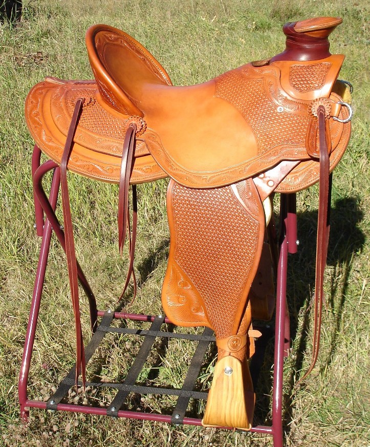

Thanks, JW - these are good calls. The curves need work - it's not the camera angles <ggg> (I need to learn to use a french curve, I think). As for the jockeys - the skirts are an inch too long in front and in back (I think) and I knew that but didn't realize it until after the tooling, and at that point I didn't want to cut new skirts (I didn't have the leather). You are right, I should have lengthened the jockeys to balance the extra skirt length (and to give the bars a little more coverage). I'm having trouble drawing patterns for the full curve skirts I really want - the ones I see in pictures of other saddles. All these points will definitely go into the next saddle. It is so worthwhile to post pictures here and get input from all of you!

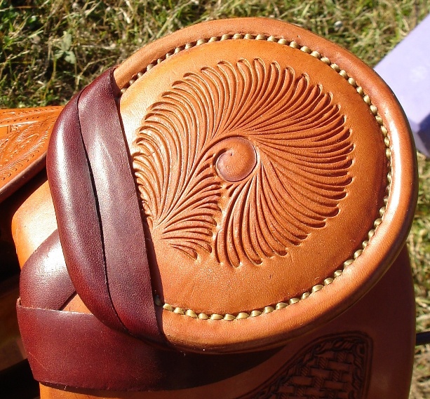

Thanks, Ann! Here are pics. The hidden stitch is not as perfect as I would like, but it's better than it used to be The cuts are freehand - I use dividers to mark spacing for the "pollywog" heads, then cut the pollywogs, then cut all the curves (first all the curves that go away-and-to-the-right, then all the curves that pull toward-me-and-to-the-right). It's a crutch to do them that way, I know, but it's how my fingers work best. I am not nearly as good as I hope to be one day - my heroes and inspiration are Claire Kehrburg and Rick Bean - and of course all my practice pieces are SO much better than the real pieces Julia Thanks, Steve - good call. I hadn't even thought of that, but now that you point it out, you are absolutely right. Thanks, Thomas! Yes, it's been a long time! And it's taken me a year and a half to finally finish this saddle (that's what comes from dithering as you go instead of having an overall plan before you begin). Julia
Hi, all, Here's my 4th saddle - it's a vaquero/buckaroo style Wade on a tree from Rod & Denise Nikkel: Wade fork Wade bars, 93 degrees 16" seat (rides like a 15-1/2" seat) all-leather ground seat all hand-stitching 5" Taylor cantle 4" horn cap 3/4 single ring rig (4" bronze rings from Bork) 4" treads in roper-style stirrups full stirrup leathers Hermann Oak leather Being just my 4th saddle, there is still much to learn - so I welcome any and all critiques. Thanks, Julia

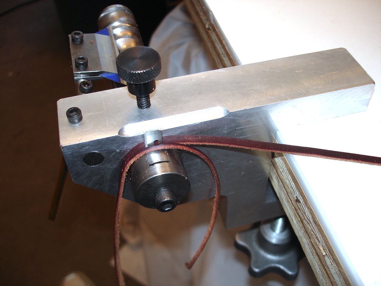

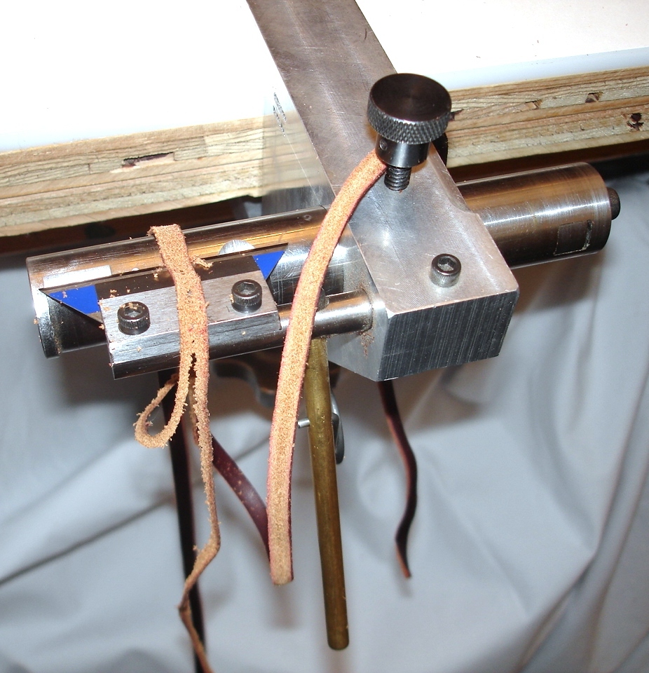

Yup. Patience. And it's amazing how fast rawhide eats up razor blades! I suspect part of my problem is the temper of the rawhide - it seems like it's always too wet or too dry, and if I ever get rawhide that seems to be perfect, it dries out before I can get it all cut/beveled. That's really frustrating, and I have not figured out the right technique/procedure for making perfectly tempered rawhide. There's lots of help available(Bruce Grant's books, folks like those here who work in rawhide, etc.) but when I'm in my own workshop it's hard to make it work. Yeah, I know - practice, practice, practice - I'll get it someday. Julia
Oh, yes, this helps. I already own the Neubert cutter/beveler, a cutter/beveler made by Wayne Jueschke, and a cutter/beveler made by the James's (recommended by Gail Hought). I keep looking for the perfect cutter - the problems with my imperfect strings are no doubt due to operator error, and I keep bouncing from one to another when I'm not quite getting the results I want. Yours (in the pictures) looks so simple and perfect that I wanted to know more about it. If you find the pics of it taken apart, please post them - I'd love to see them. And thank you again for the tutorial. Julia
