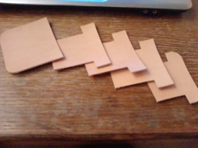

I have another 6" X 3" piece which I sew the pockets to. I glue the top piece to it first. This top piece has no other purpose other than to cover the flesh side of the 6 X 3 piece. Then I glue the second piece's side tabs and edge of bottom only, just below the top piece. I thenX stitch the bottom edge ONLY. Then i glue the third piece's side tabs and edge of bottom only, just below the second piece. I then stitch the bottom edge only. And on it goes, till all pieces are assembled, then I stitch all around the 6 X 3 piece, securing the tabs in the process. -

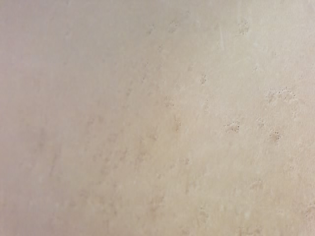

Yes, I found that people who told me that they are satisfied with Tandy are usually the ones who walk in and choose their leather. For the 15 hides you went through, you found only one good one. For the rest, it has to go somewhere, right? Is it the right thing to dump it on us, the mail order customers. I feel, to be fair, if they have problems selling these hides to walk in customers, they should not just see mail order customers as an outlet for them to get rid of these leather. Instead they should either speak with their supplier, or stop importing these leather, or REPRESENT IT ACCURATELY as covered with insect bites, and not use the word occasional. As it is, it does not add character to any project of mine but just adds more crap to my scrap bin. If you can call a complete 24 sq ft side a scrap. I have a customer who mentioned he was interested in picking up leather craft. After giving him some tips on what is necessary to order, I discovered that he is going to the US to study in July. I told how much I envy him as he could actually walk in to a store and pick out his leather instead of sending money across the continent and crossing my fingers hoping I won't be burnt for the 3rd, 4th, 5th, 6th, etc... time. I should just pick up another hobby.

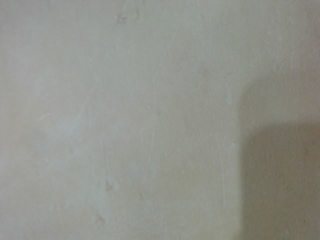

This is a side I received from Tandy. I took several pics, and they ARE representative of the ENTIRE hide. TANDY CAN SUE ME IF THEY WISH TO DISPUTE THAT!! I am extremely angry now because they have simply not replied to my emails about this. I am fully aware this is advertised as a economy side. But look at it this way, I not only pay for the leather, I have to pay for the shipping as well. Which is about $35. So for every inch that is unusable, not only the leather money goes down the drain, so does the shipping money. And I would have been happy if I can get 10 sq ft of clean leather out of a 24-26 sq ft economy side. BUT THE ENTIRE SIDE??? There was also a $5.59 per sq ft calf veg tan which was advertised as clean carving leather. Clean! It is almost as bad as this economy 3-4 oz side! I was so angry when I saw it that I used the lace cutter to cut half of it into lace simply because I could not stand looking at it. I made a mistake of braiding a couple of cords plus lined 4 wallets. It was a desparate attempt to myself to justify the purchase of it and also to used it so I don't have to look at it. But it was a mistake, because what is not usable, simply shouldn't be used. I ended up throwing away the cords, and then had the wallets returned from unhappy customers, and I threw them away. So I also wasted the HO leather which was used to create the wallet outers and inners. Before, already I would received one liner brusque replies to my enquiries. Now there is a problem, NO REPLY! AGAIN, SUE ME IF I HAVE SAID SOMETHING UNTRUE! They give me the feeling that they take overseas customers as easy prey and send the lousiest leather to them as it is more difficult for them to return the leather. But do we pay any lesser than US customers? Should we be treated this way? Is this preying on the small guy to line the pockets of the corporate big wigs? I HATE TANDY LEATHER FACTORY! Now i just have to go dig out our family book of curses. I am considering setting up a website just dedicated to showcasing these leather they have exchanged for my hard earned money.
