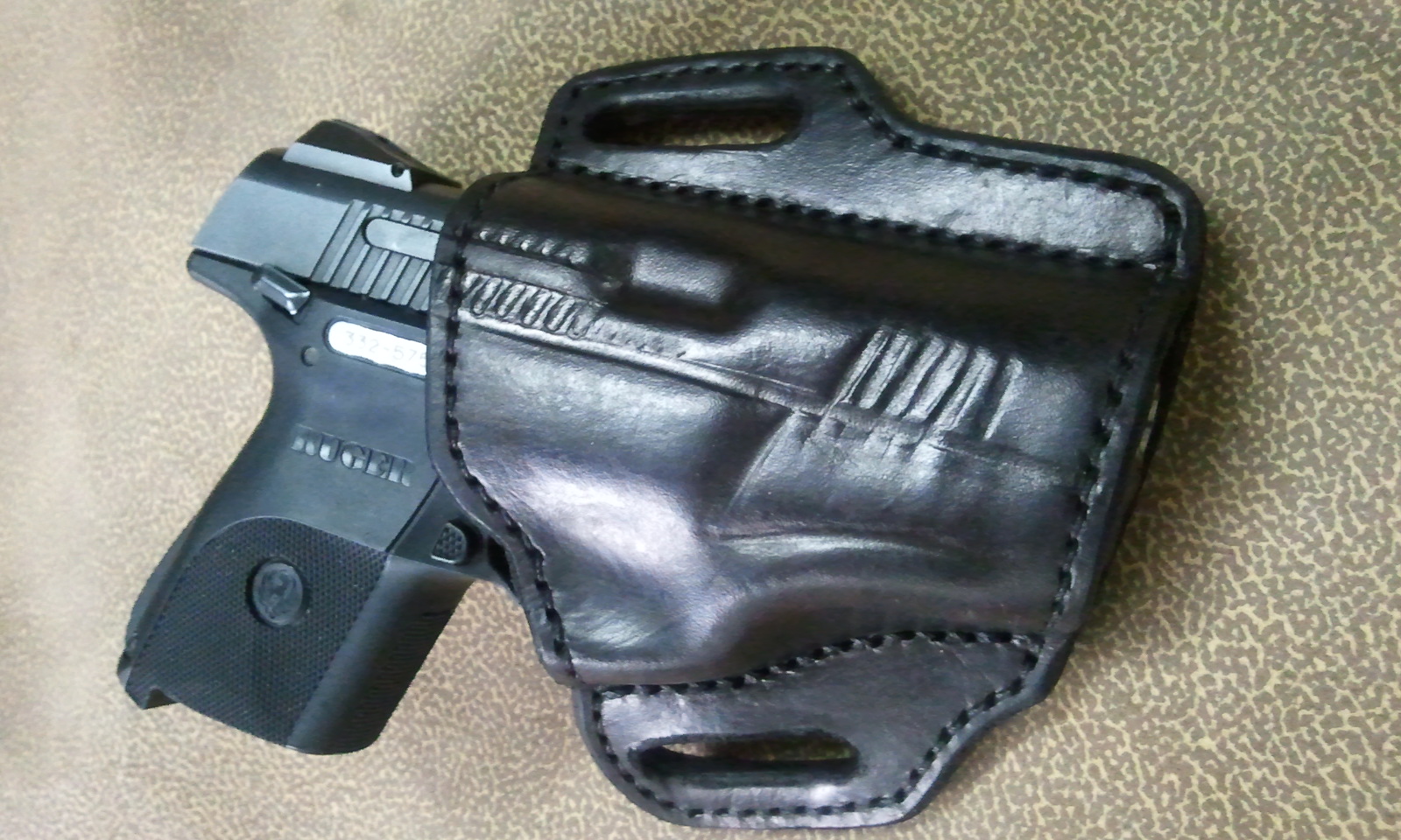

Here's my 2¢ worth: any time I have a difficult customer, I add an additional charge for the "ick factor". That charge varies depending on how much of a pain in the butt they are. Sometimes I'll quote them a price so outrageous hopeing they'll go elsewhere for the work. This is then a win win situation for me. Either I dont have to deal with their BS, or I will make a lot more money than normal. I also add $20 to the price anytime I have to order a dummy gun, and always get half up front if they are local and paid in full if they are not local. The other thing I thought I might mention is the quality of your work. Your molding looks very good and your stitcing also looks good. The only thing I would do different is stitch much closer to the gun. In time the leather will soften and the molding will open allowing the gun to wiggle and move inside the holster. Here is a picture of one I made for a Ruger SR9C. Otherwise, great job and keep up the good work. quote name='glockanator' timestamp='1335727589' post='245728'] He came through with the judge but not the sign paid up front also. This is what I came up with.
