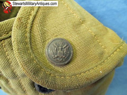

  5. I was wondering if any of you guys know where I can get these style of snaps. I know someone make them. I see them on repop WW1 ammo belts and such. Just need a little help tracking them down. Thanks, Chris

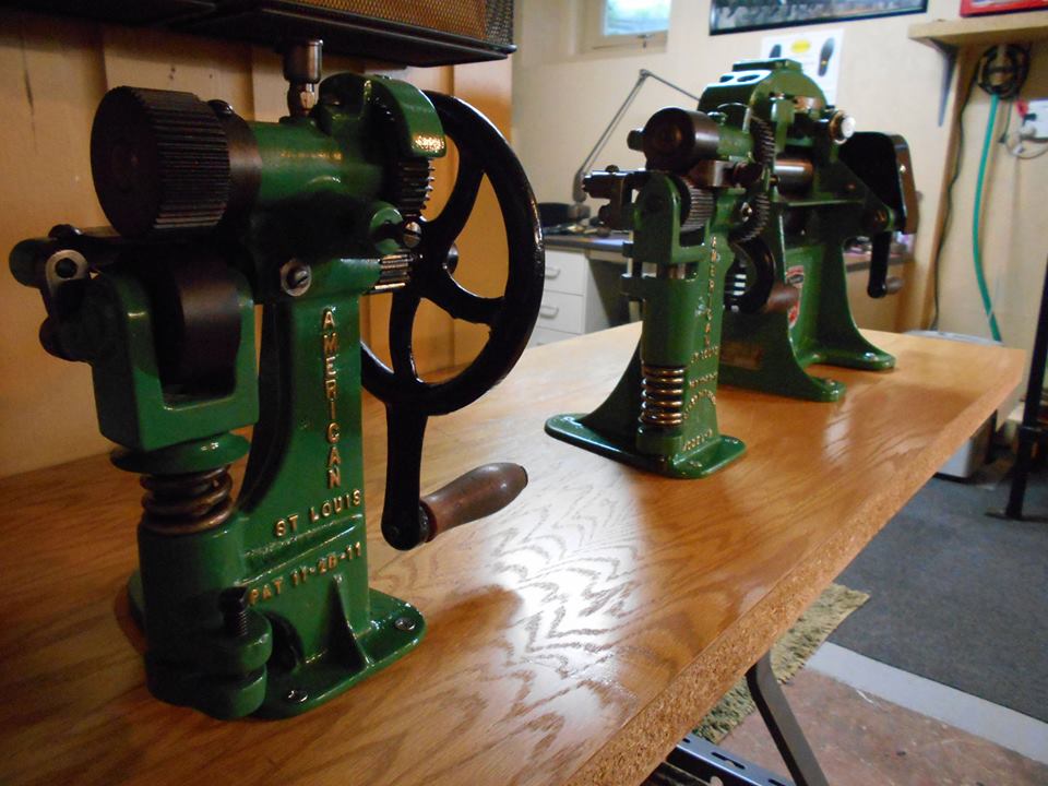

  7. All three are completely restored and are in 100% working order. I am missing a few items on them and maybe somebody can help me find the parts I need. The Skiver on the far left is missing the Guide fence and the middle Skiver is missing the Gear guard. I have already emailed Harris @ Pilgrim, but if you have what I am looking for please PM me. Chris

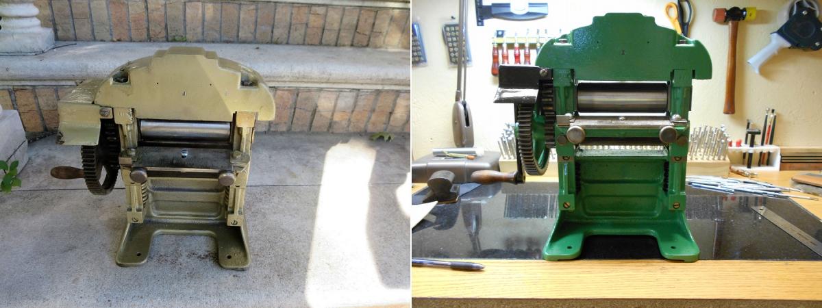

  8. Thank guys. I have been called anal from people because when I buy an old tools or machines I can not stand it being in poor state.
  9. It took awhile but it now done.

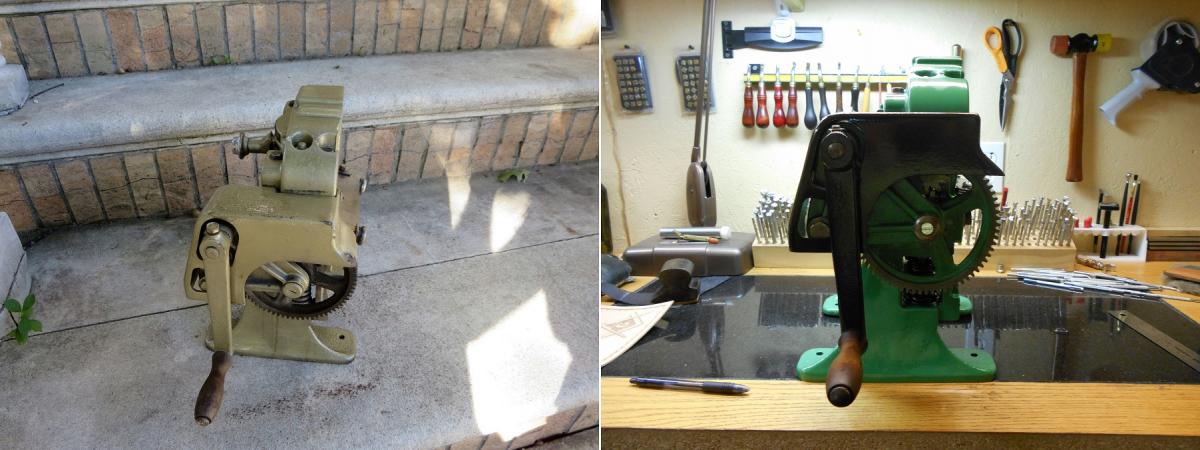

  10. I was wondering if anyone has a Landis 30 owners manual. I read in the search area there was a photocopy floating around. I have the one from Pilgram that is online, but I was hoping to get a copy of the original for the Machine settings. I am willing to pay for a copy if anyone is willing to share. Thanks, Chris
  11. Can some of you guys with original paint schemes or referbushed take a few pictures of the front, back and two sides of your Landis 30? I just recently purchanced one and the color on it is very (how shall I say) nasty. Thanks guys, Chris
  12. Leo I got it out. It is so gulled up I have to take it into a Machine shop and have the drive pinion stud remaned. When I get it back I will be drill a dimple in the flat spot so the bolt will seat proper. Thanks for the idea. Chris
