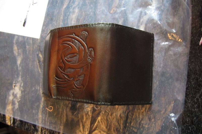

First Wallet
Josiah replied to Josiah's topic in Purses, Wallets, Belts and Miscellaneous Pocket Items
3-4 oz Hermann Oak -

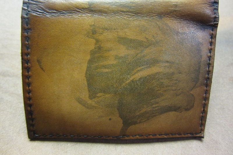

I stained this wallet using light brown oil dye from Fiebings, waited a day and wiped on a coat of Fiebings dark brown antique paste and was left with this nasty smudge. I have never had this happen before and am wondering if anyone has seen this type of thing and knows how to keep it from happening again. I did have a some liquid sitting on top of the paste that I tried to mix in, but may not have mixed in very well. Just not sure if that could cause it or what. I saved the project by deglazing, and then spraying a dark chocolate dye fade.

This is the first wallet I have ever done, along with the first time hand sewing, sadlle stitching or anything other than lace. I had my sister-in-law order one for her husband, and I needed to do one real quick so all the mistakes weren't on his. It is using coat thread which was the heaviest duty stuff I had laying around, but I think I need something a little thicker. I used a Chaylor-Fennelli interior which is why I didn't bother taking pics of it.
