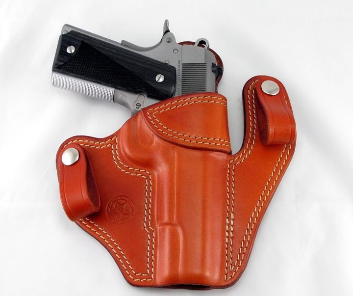

Not sure if there is one yet. As mentioned previously, I stitched the reinforcement first. By doing so, it was difficult for the machine to go into the corner of the wing once folded over. I may try sewing the wing first next time. However, that could prevent the inside of the holster from mating together flush. -

I stitched the reinforcement first. However, the next one I do I'll sew the wing first. -

Hey folks! Just finished up this IWB a few days ago. I got the pattern from Boothill Bob. This is the first hater of this type that I have done.

Thanks Tim. Yeah, not sure what was going on with the site last night. I originally tried editing the first post, but was told I didn't have permission. Boothill Bob took out the guess work with his pattern pack. But now I have to figure out how to make this style pattern for other models -

What brand snaps are you using? I tried 8-32 and the screw head would sit down into the stud on some of my off brand snaps. The screw head diameter was too big, dropped to a 6-32 and it worked just fine. -

I really enjoyed this thread. I took a few things from it and applied it to my latest holster. I used size 6-32 tee nuts and 6-32 flat top 100 degree screws. I placed the tee nuts on the outside of the leather as I was worried I may hit it with the sewing machine needle. -

Brigade Gun Leather uses the t-nuts on their IWB holsters, looks damn nice too. And they're exposed on the backside. I believe I'll expose mine when I get around to working on an IWB in the near future. I like the idea of how a sandwiched nut would look. However I use a machine and don't wanna hit it with a needle. Plus, if it strips out it can easily be replaced by the user. -
