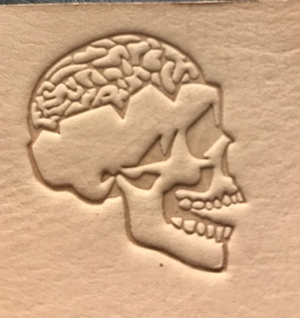

this is a companion piece to the firefighter I put up last month with the resulting embossing. 3" piece of brass for a wallet back plate. I've done and shown this one before made from Delril but these brass ones should pretty much outlive me.
thank you! and just in time for the new movie.

there is 2 hours of work in this plus a good $15 in the brass alone so in the $100 range. kind of tough to compete with the hong kong phooeys. both the alien face hugger are available in delrin for $75 here is the companion piece the alien facehugger.
this is a 1/2 of a wallet back plate I've done before in plastic and the resulting embossing in leather. this was cut into brass. I'm extremely happy with it and it will likely last forever. Kind of timely too with the new movie coming out soon. I'll likely have a facehugger companion piece done this weekend. cheers!
