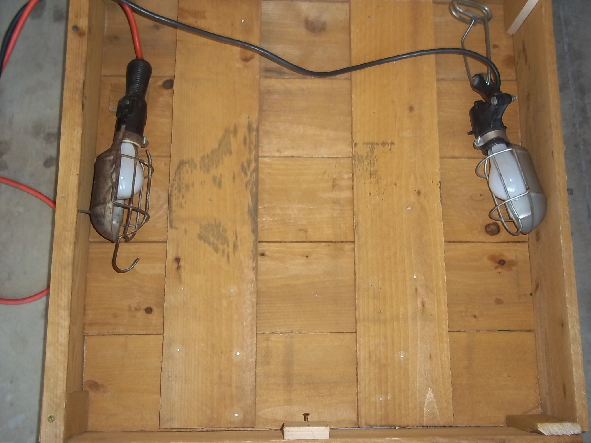

How Do I Get My Holster To 125 Deg To Harden It
brathair replied to mlapaglia's topic in How Do I Do That?
Here are some pics of the setup I use. It is a simple box made of the drop from my cedar fence posts. The boards are rough cut and just laid next to each other before I screwed them together. This makes so there is about a 1/16" gap between boards. I believe the dry cedar along with the gaps in the box make for better drying. The added benefit you get from the cedar is a pleasant aroma. I use two 100w work lights as my heat source. I used to stick a thermometer inside the box and watch the temp closely. However I found that the hottest this box will get even after hours of running is about 132 degrees, so I don't even worry about it anymore. If you do decide to build a box use a non-sappy wood like redwood or cedar. All in all the box is about 3'X3'X6" plenty big enough for several holsters, and most any of my projects for that matter. The box also has a cedar lid made of the same fence post boards. You can't see it in the pic but I just lay the top on...no hinge. -

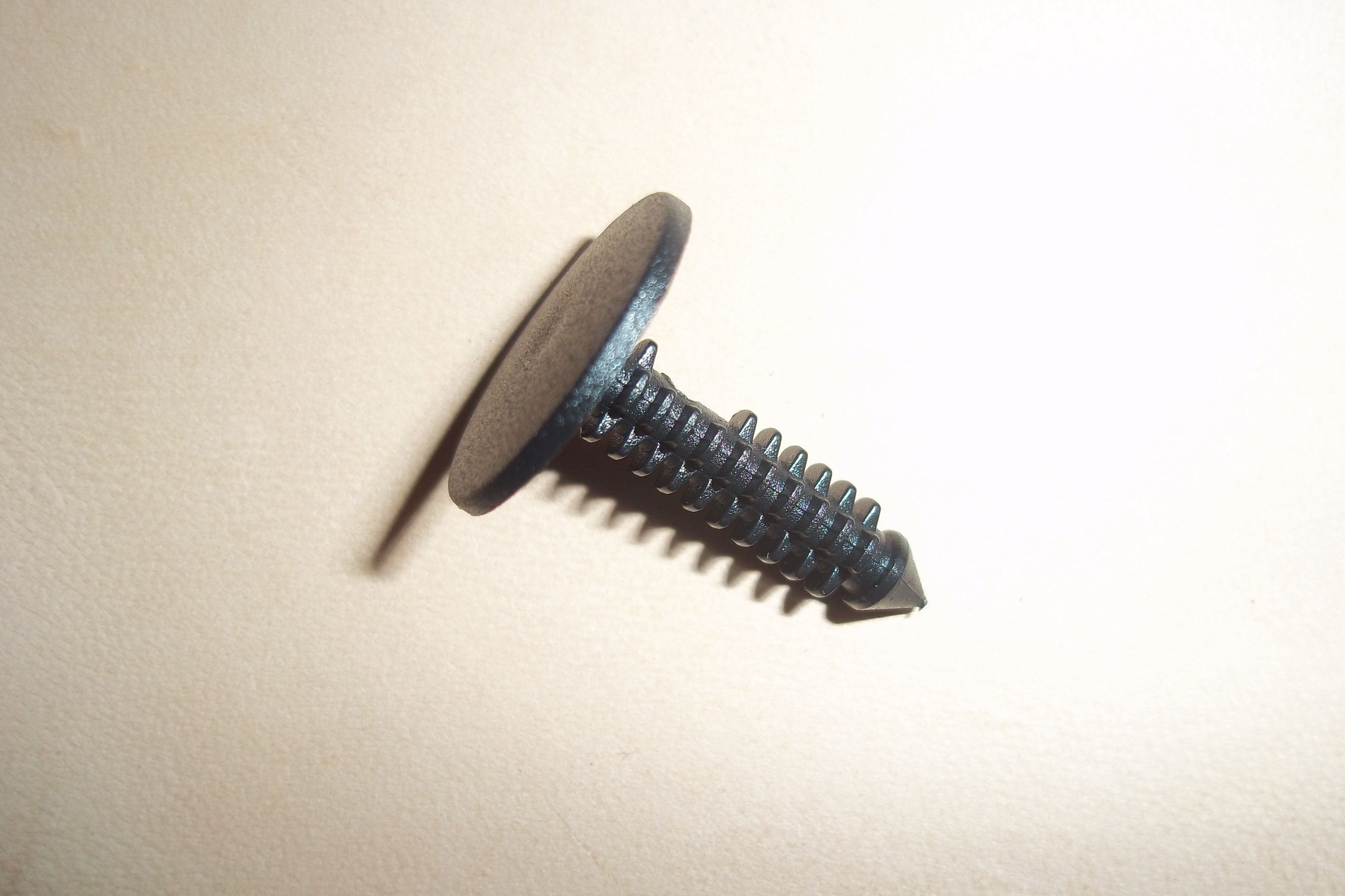

You should be able to find everything you are looking for here. http://www.highdesertleather.com/id74.html If you want something local to you I have had some success in the local hardware stores and automotive parts stores. You can attach a metal reinforcement piece/ thumb break with the snaps of your choice. You can then purchase plastic pieces that protect the guns finish from the snaps at the hardware/automotive stores. What you will be looking for is the plastic thumbtack looking pieces that are used to secure upholstery, door panels, and the like to the interior of cars. They look like plastic thumbtacks with barbs, but I have no idea what these fasteners are called. Just push them into the hole in the center of the snap back and trim the inside so it does not effect how the snap functions. below is a picture of one I have used with Tandy line 24 snaps.
