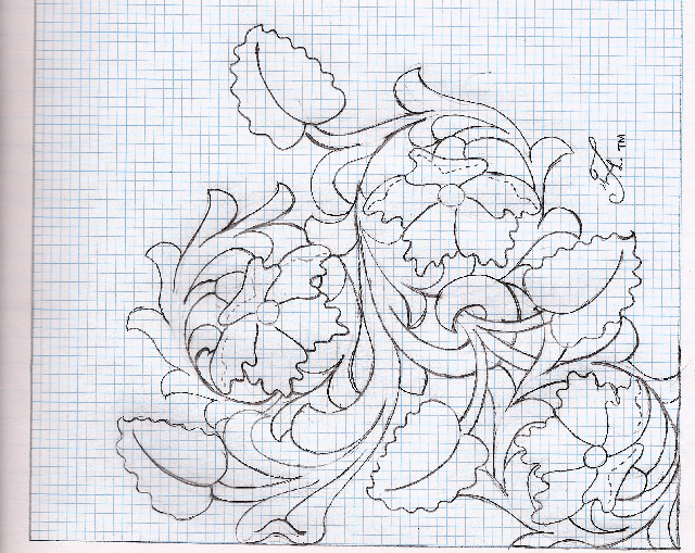

Clay, When I saw those in my email, I swore they were photos of what he was planning to tool. My goodness this guy is good. Glad you posted these in this forum to let others see. Wouldn't ya just love to be an apprentice of this guy? Marlon
