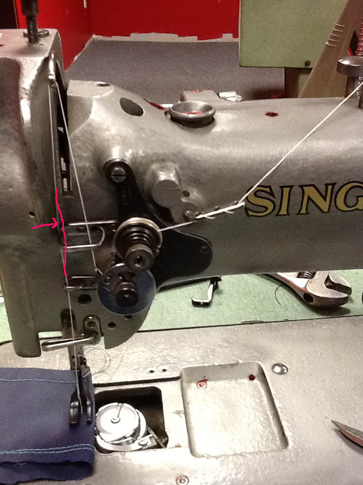

I edited your pic again Tom to correct my poor photoshop. You'll see that thread inside the guide now. I don't want to throw someone else off. I also show that it's ok to use only two hole going into your tension disks. Sometimes with stiff thread, you create too much back tension with too many guide holes and it doesn't allow you to adjust your tension the way you want. Almost every manual I've ever read will instruct you to set your needle and bobbin tension just tight enough to set a balanced stitch. If you start too tight, you've no where to go to pull up your stitches correctly, usually because you can't tighten the bobbin tension tight enough. I always start with my tensions loose and adjust from there. Regards, Eric -

You've missed the guide on the way down to your needle. It's likely pinching where the guide's mounted. I reattched your pic so you could see it. My red line should go inside that guide, but I think you get the idea. Regards, Eric -
