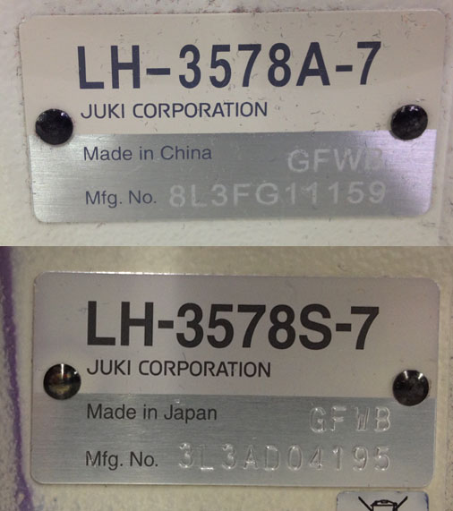

Here you go Steve. The plates are the same size and are both riveted to the casting. I've heard of some folks taking the blue Juki decals off and putting them on clones. I guess another good reason to go through a reputable dealer if you're unsure. Regards, Eric
I'll post a pic tommorow night of each of the country of origin for my two double needle Juki's. Easy enough to compare. Regards, Eric

I can't really speak for the Cobra machines. I have worked on lots of Juki's. I do know that the Juki's made in Japan are superior to the Chinese. Juki has had to contract machines to be made in China due to price point pressure. I have 2 identical models of Juki double needle machines. The older one (6 years) was made in Japan. The one I bought 6 months ago was made in China. At least in our factory setting, with regular maintenance but with 40 hours a week of hard use, the Japan machine will outlive the China one by a long shot. While the Chinese have made strides in their machining abilities, they lag well behind the models made in Japan. The difference shows up in the tolerances of the bearing stays, bushings, the shafts, needle bars and gears. It will translate to excessive play which simply can't be compensated for with adjustment. That aside, for home shop use, the Chinese machines should give good service if taken care of. I personally wouldn't buy a China made machine except from a dealer offering support. Just my 2 cents worth. Regards, Eric
