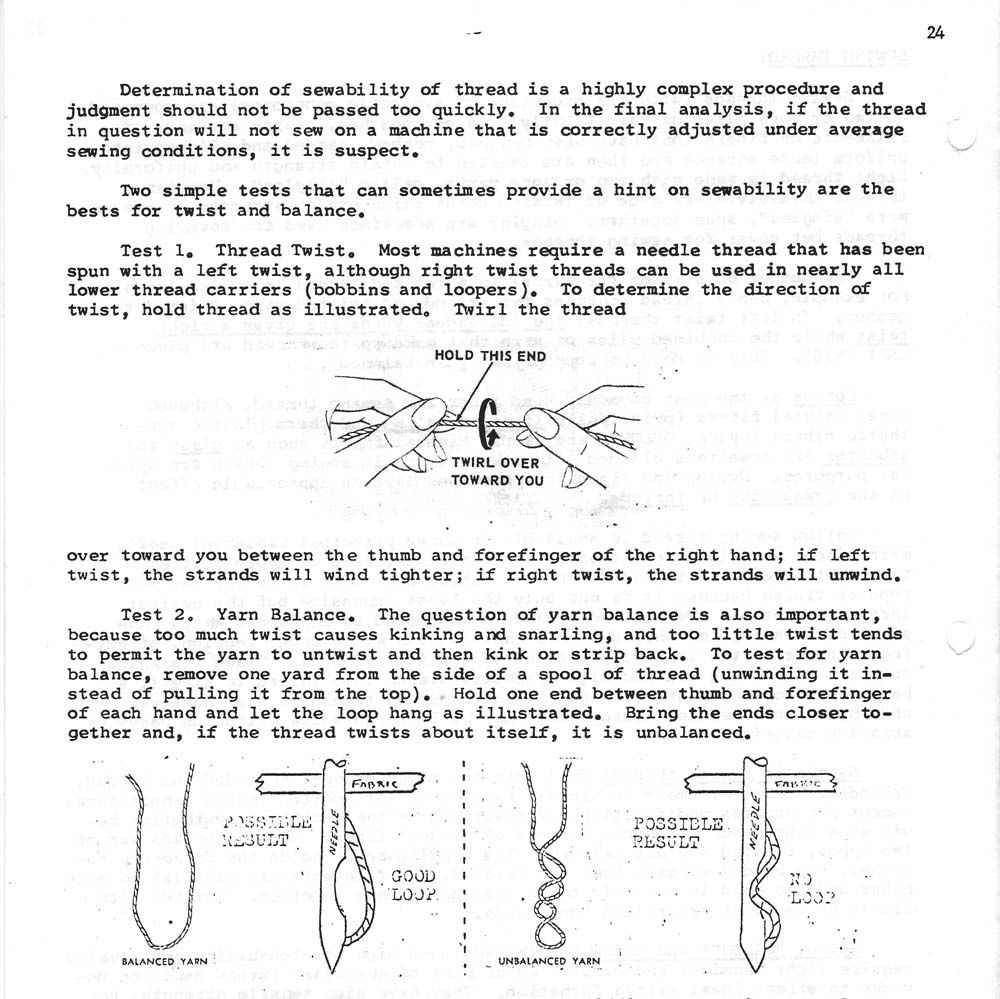

Here's some information to consider if you're using a thread for the first time. Keep in mind that even if you've been using a particular thread, size, color etc., cones of thread vary. Sometimes within the same cone. I don't like to blame machine problems on thread, but there are times when one minute things are working great, the next not so much. Something I like to do when I'm using a new thread is check how tight it's twisted. The picture shows the exact method I have used for years and the problems that can arise. There are ways to overcome these to some degree, but sometimes you have to grab a new cone. We use up thread that's less than desirable on bobbins or loopers on chainstitch machines. Even using the standard "can I use this thread with this needle test" doesn't always tell the real story. If you have a thread you want to use with a certain needle size. Try it. See what it does. Don't lock yourself into a chart. Granted, there are some threads that simply won't go through certain needles. There are however, many shapes of eyes in needles. Different brands of needles have different shaped eyes. Whenever you're dealing with needles and thread, think about the loop that the hook must "pick up", You want the loop to be as consistent as possible to avoid skips, broken thread, and poor appearance. Increasing needle tension will make a loop smaller, loosening will make it bigger. Your bobbin tension will have to be adjusted accordingly. With thread that's wound too tight, this is a good way to make the loop more consistant. With a smaller loop, your timing must be more precise. You can also "retard" the timing of the hook, that is making it come in later to the loop, closer to the eye where the loop is more likely to be more consistant. You can also turn the needle slightly towards the direction that the hook is going to pick up the loop. Doing this presents the loop at a different angle. On thread that's slightly too small for a certain needle, you can actually wrap the thread one time around the needle before threading the eye. When trying new threads and needles, I always consider what my "loop" is doing. Getting used to this concept will allow you to expand your machine knowledge and what your machine's capable of. Regards, Eric
