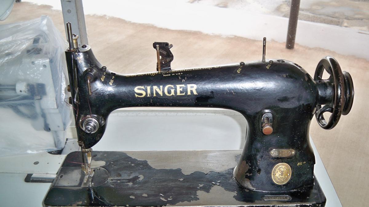

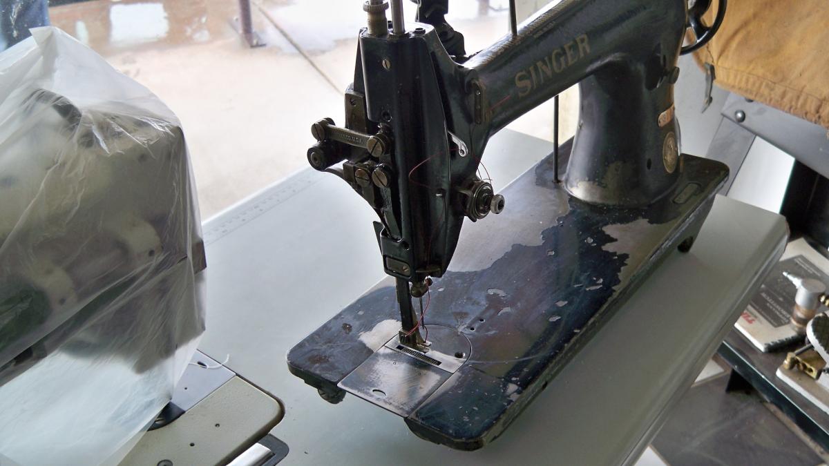

Older singer 31-19 sewing machine for sale. It is a snap-foot walking foot. A little rough but works OK. $125.00 for the head + shipping or I have a treadle table for it with a nice top and period Bobbin winder that I will take $350.00 + shipping for the head and stand complete.
