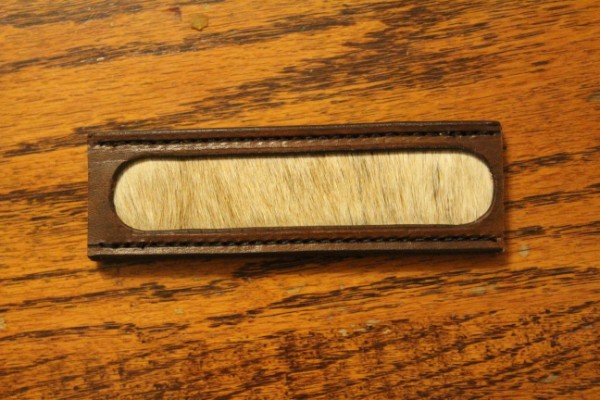

Well, here is the latest test sample. I do believe I am just about ready to try a full belt. This time, I did the stitch groove and used some tacks (smallest finishing nails I had on hand, but for the real project will use even smaller ones) prior to sewing. I had four down each side (just less than 6 inches), but I think they could even be spaced closer together on a long run. Although edge finishing went a whole lot easier having the hair lay 'vertical', I really prefer the look of the hair when it lays horizontal or at least at a bit of an angle. Will have to decide what I am willing to put up with before cutting into the main hide. Comments, criticism or any blatant faults, let me know. Thanks to all have given their thoughts and pointers so far. JJ -

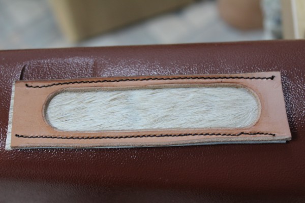

Thanks Bruce. I have never used a groove for anything I sew with the machine - will give it a try and makes sense, cause that is where I would have used tacks when hand stitching. Lay of the hair makes perfect sense - all things that a person would likely learn from experience (read mistakes) but having this site to access tips from others is priceless. -

Well, here is my first attempt at a practice piece trying to apply the above pointers. Definitely not happy or ready to be making a belt yet. To top it off, had just changed out plates, needle and thread on the machine, and didn't adjust tension or stitch length or do any practice run, so stitching on first side was horrendous. There is no dye applied and I only tried edging the top edge. Bruce - When you tack the edges, how can you be sure the stitch line is going to pass over the tack hole, so no extra holes show in the leather? After I trimmed, sanded and singed the edge, as soon as I started burnishing with my canvas, more hairs showed up, repeated the singing process a couple more times, but the finished edge still has hairs embedded, that may stand up. Anyone else, feel free to chime in ....... Thanks JJ
