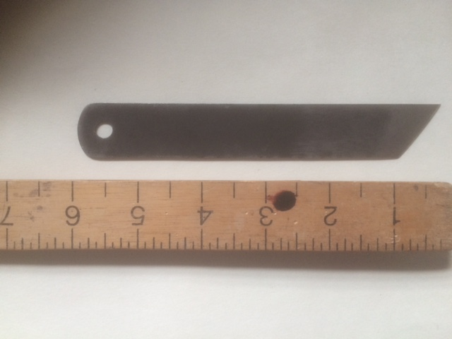

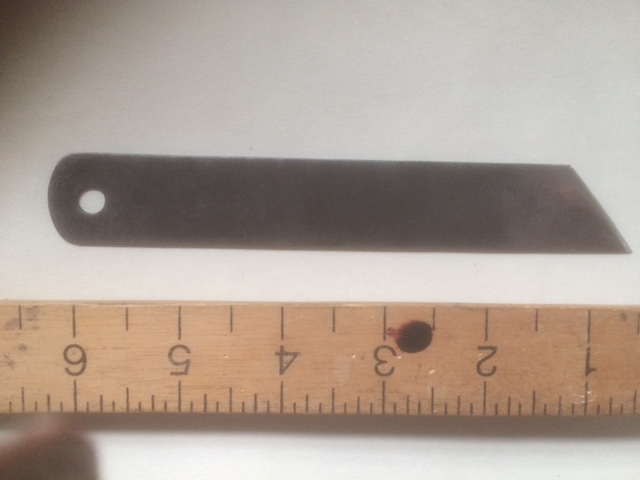

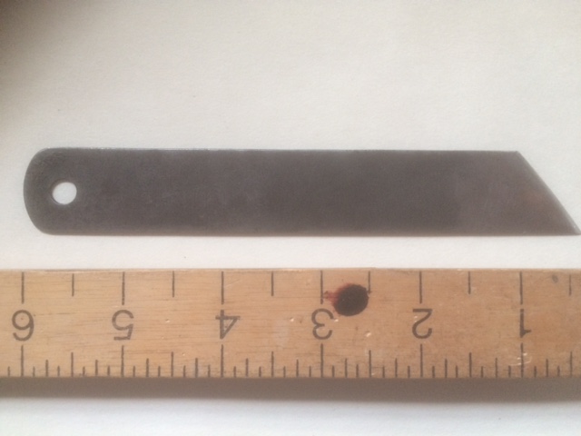

I made my own paring knife out of a industrial hacksaw blade. I ground off the teeth then honed it both sides. I can use it on either side when I am paring. I made this about 25 years ago and use it for lots of jobs. I posted a video on here the other day called how to tie a knot. You can see the knife in my hand. I will try attach a picture of both sides on this. -
