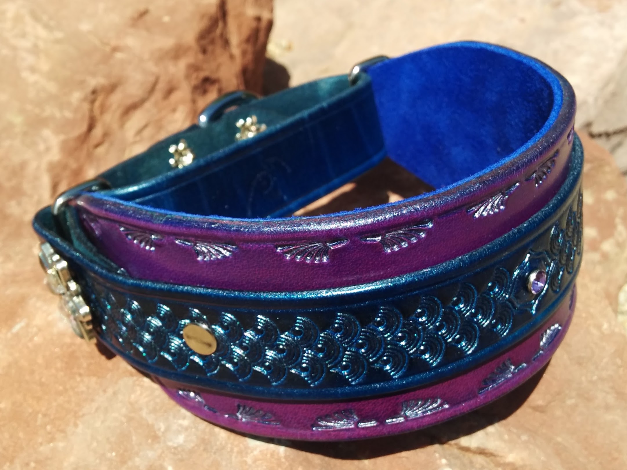

Martingale Collar for my newest hound
Michael Sheldon replied to Michael Sheldon's topic in Collars, Cuffs, Leashes and Leads
I've never had the barge fail on me as long as I applied it properly. The suede holds up, but a lot has to do with how it's cared for. If it's brushed and cleaned frequently, it stays looking pretty good. If not, it eventually slicks down. Since these are collars for sighthounds, and they don't tend to have much if any oil in their fur, it's not difficult to keep clean. And usually, fancy collars like that one, don't get left on the dog 24/7. -
#14 is sufficient, #12 at most IMO.
There is minimal adjustment for length, +- 1/2" where the strap turns under at the concho. But yes, definitely made to size. Not sure what you mean? The inside is lined with suede, glued in with Barge. -
