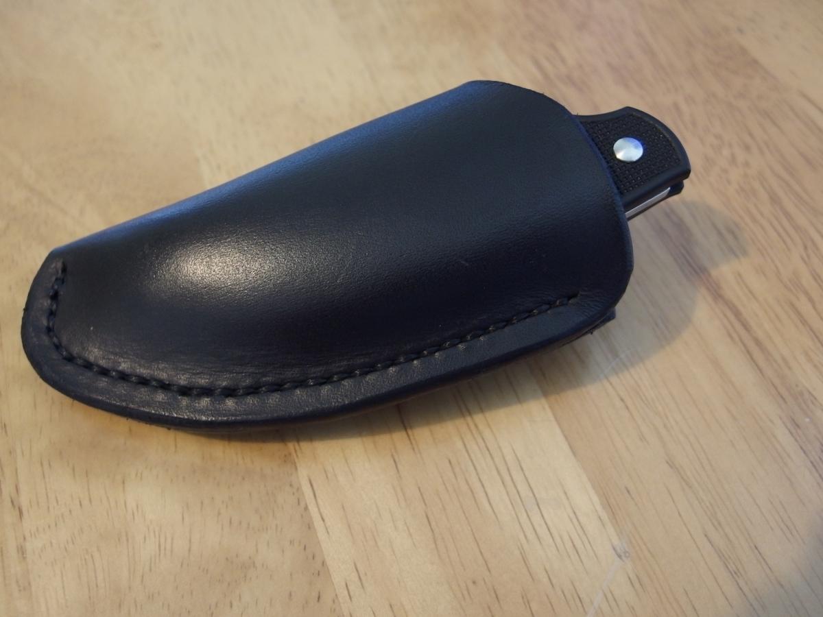

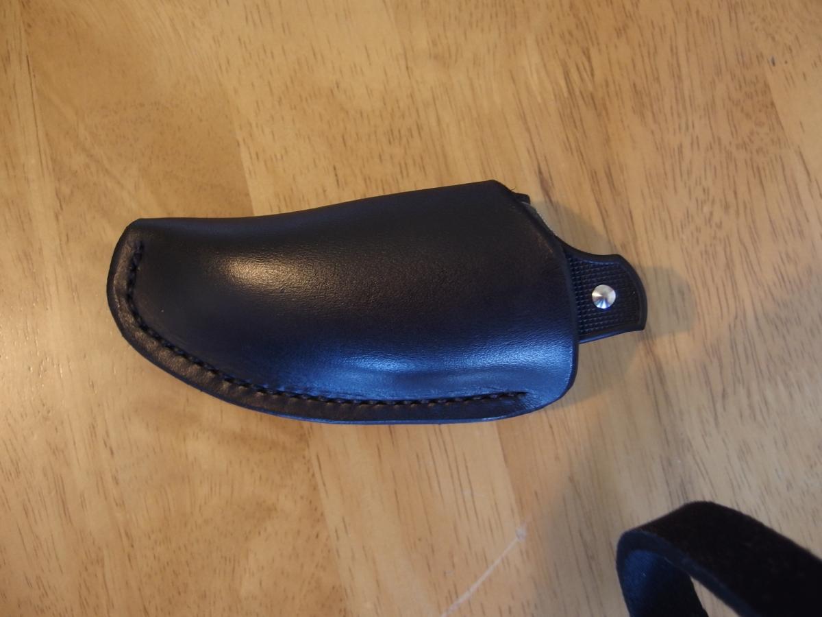

This my second fInished project; a knife case for my spyderco knife. I'm really pleased with the results of this and, would love anyone thoughts and suggestions. Reading this forum has helped me no end and helped me improve, in fact without it, I don't think I would of been able to make it at all Thanks for looking
