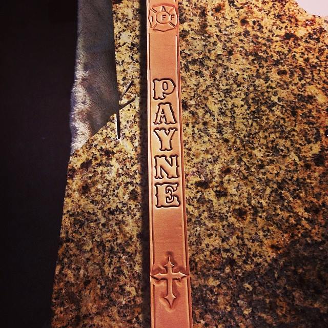

  4. Hey all! I guess I haven't posted any work yet... So I guess I'll post my most recent project. Here is the backside of the strap. This is also before the edges where burnished and about 5 minutes after the carving/beveling so I assure you the finished product does not look remotely this rough. Sorry the angle of the picture is off but it is what it is! -Steddum
