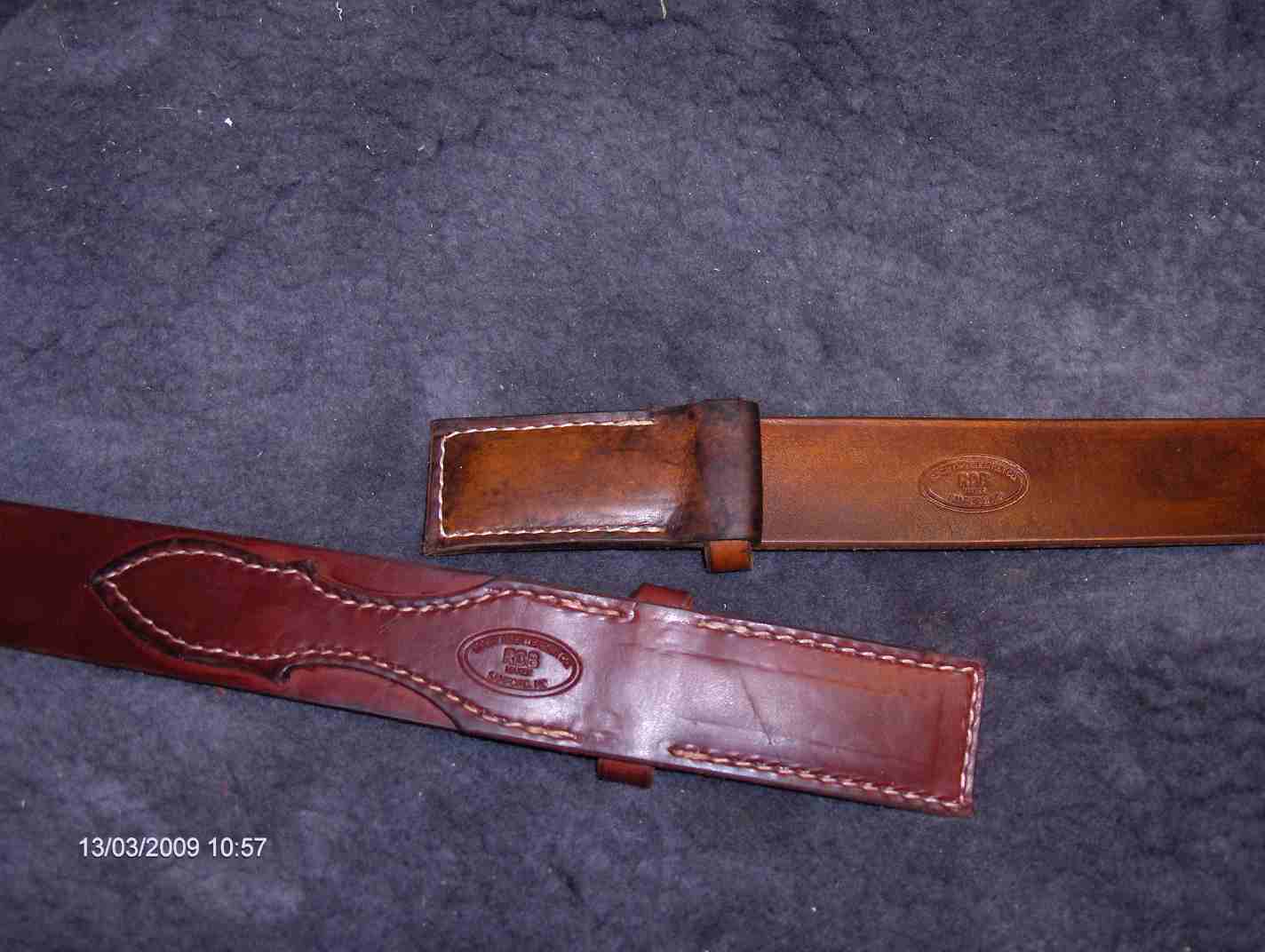

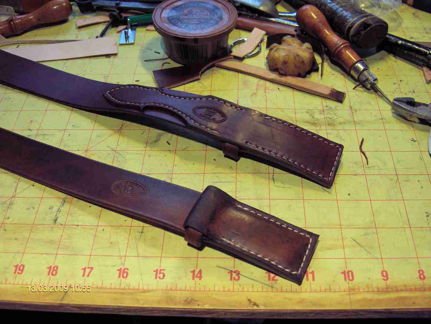

I've had a few people ask about these type of belts, so it's time to make up a batch. Here's the first two. I don't have a splitter, which makes it easy to make the simple kind. With the splitter, you just split back 4-5 inches, place the buckle plate, and keeper in, then sew it up. So I have to use a little creativity... The brown one is bullhide strap, with a calfskin top. Skive the strap tip down, place the buckle plate, fold over the calfskin, glue, and stitch. This one is Walnut oil dye, mixed with neatsfoot, covered with Sno Proof. The other is Chestnut Bridle, with Ranger style billet top. Handstitching would probably look better, and be able to sew tighter to the loop. It would also allow you to sew the loop in, in the more traditional style (ala Stohlman). But for production type, these look/work okay. For those who haven't made these, you can get the plate with either one or two tines. They also come in brass, if you can find them. I haven't so far. But a lot of makers have some metal shops make up what they want from brass and SS...that's a route, I may go. In general, I've seen these go for 16-20 dollars on the low end. 30-50 for slightly better quality ones, 70-80 from craftsman, and as high as 120 from nutcakes , I mean "designers"...lol I've dreamed up different versions for Bikers, Musicians, and Hunters. With a little salesmanship, I should be able to promote these outside of the mechanic crowd. Thanx fer lookin....As usual, feel free to show pix of yours, too
