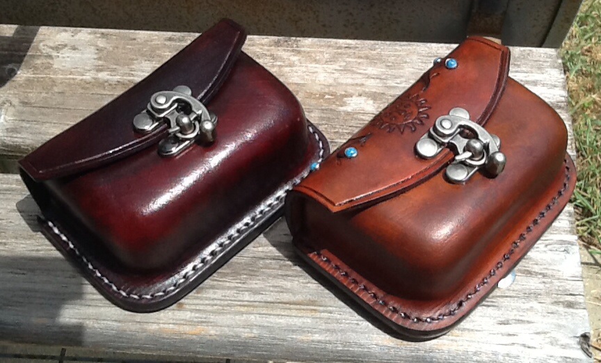

More Pouches
Quillleather replied to Quillleather's topic in Purses, Wallets, Belts and Miscellaneous Pocket Items

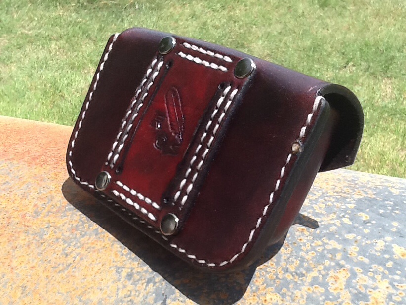

Did An Iphone Holster
They are single cap so the backside/ inside is very flat. And the holster is designed to fit a phone that is already in a magpul protective case. Since I made this for myself I didn't line it for protection from rivets. That all being said, if I was going to make one for someone else I probably would line the inside for scratch protection. Thanks for your feedback, I appreciate it! -
Used standard daubers from tandy to fade this. Did light coat of mahogany over the whole thing, then come back with Scarlett red concentrating on center area. Then work around the edges some more with the dark mahogany . Alternate back and forth with the two colors until you are happy. Keep the lighter color in center and darker towards edges.The colors bleed into each other and create a faded appearance.
Thanks! Glad you like it. It gets compliments when I am out and about like, "where did you buy your iPad case, I love it". Then I have the pleasure of saying I handmade it. Lol. The flag was traced and then cut in to the leather using a swivel knife, then I spent a late night hand painting and airbrushing the dye colors on. It all gives the illusion of the flag waving.

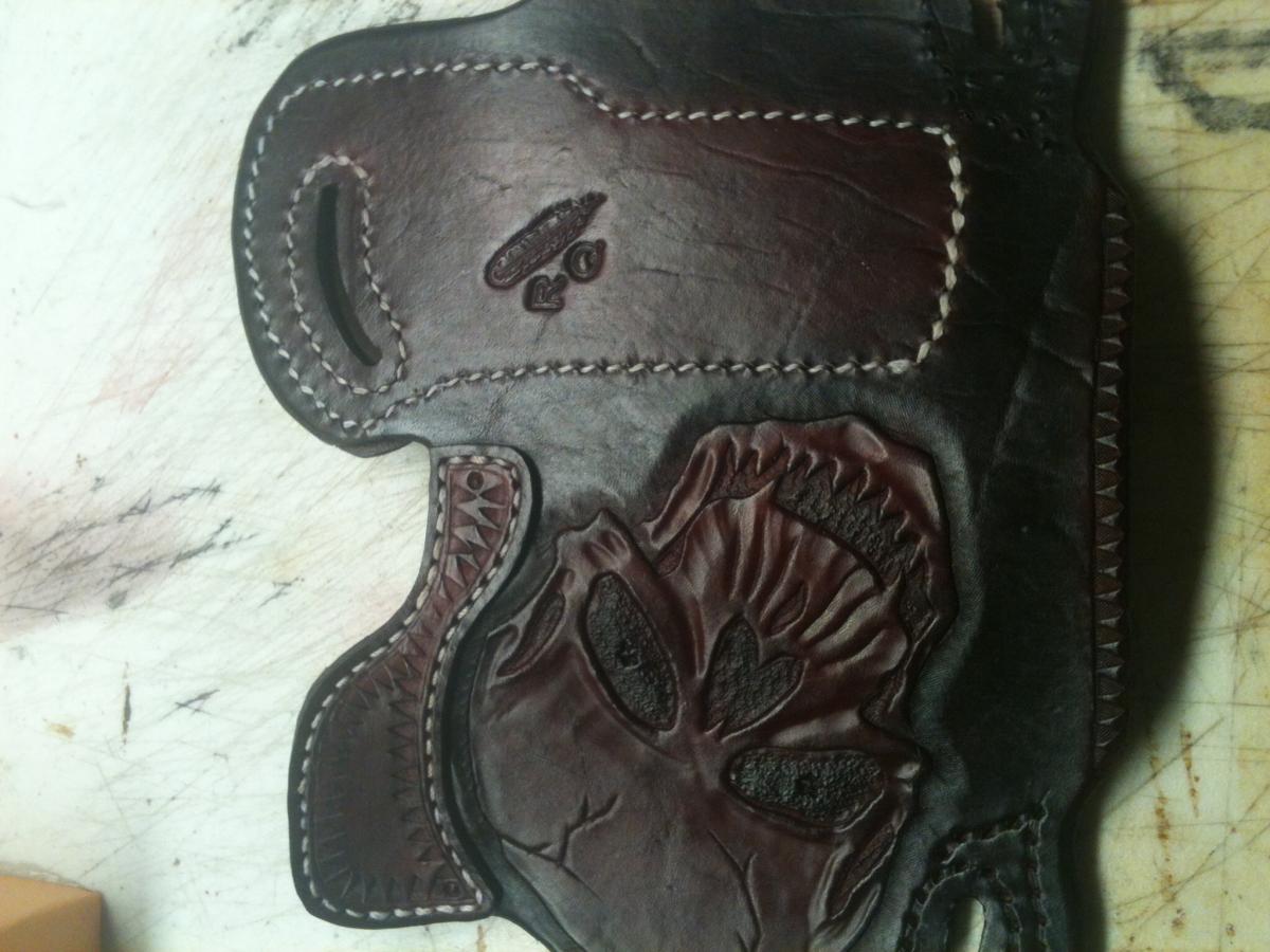

Purple Jeweled Holster For Her
Quillleather replied to Quillleather's topic in Gun Holsters, Rifle Slings and Knife Sheathes
The jewels are the rivet type. The front is lined with black pigskin to cover the rivets on the inside so they don't scratch the gun. My wife doesn't really go to the range and practice so drawing the gun repeatedly is not really an issue. Mostly used for daily wear and to look pretty like girls want. Thanks for asking!- 2 replies
