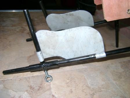

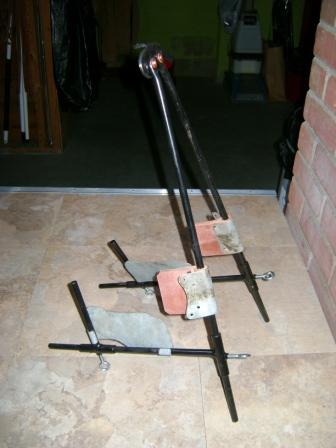

almost forgot the rigging gauge. You nail the top with the hole on the center of the swell of the tree. You tack the leather/metal tabs on each side piece in between the front edge of the front rigging leathers, then the lower bar that runs horizontally is used to rest the rigging ring on and the bar on the back of that bar you adjust to the back of the rigging ring. You measure this on one side and adjust the other side to the exact same measurements and adjust and tighten screws. Then tack on the center of swell again and adjust your rigging on the other side to match and everything should be the same.

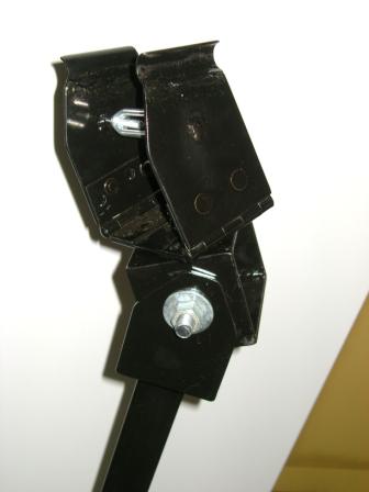

Also included is Old George. The top bar is turned to press out and lock on the inside of the tree bars. The middle bolt loosens to allow you to swivel right to left, and the bottom nut loosens to allow tipping. I still think the old stuff works great. This is on a long pole that you can adjust height and a wide wheel base.

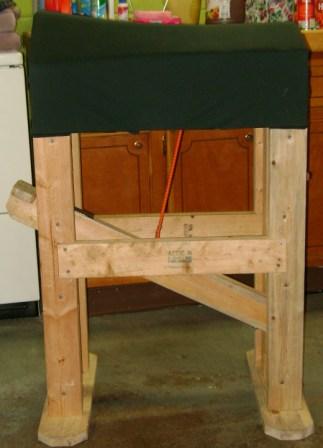

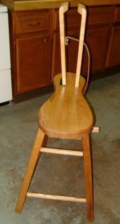

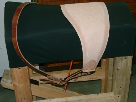

as promised, stitching horse, When you use your foot to press down, the clamps are drawn tight with the leather strap. You can lock in place as the bar is notched. Here is the saddle stand. The draw down strap is laying on the top. Again you would use the foot press and lock it in. Does a great job forming/turning fenders as well.
