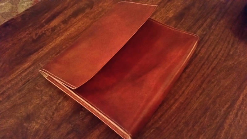

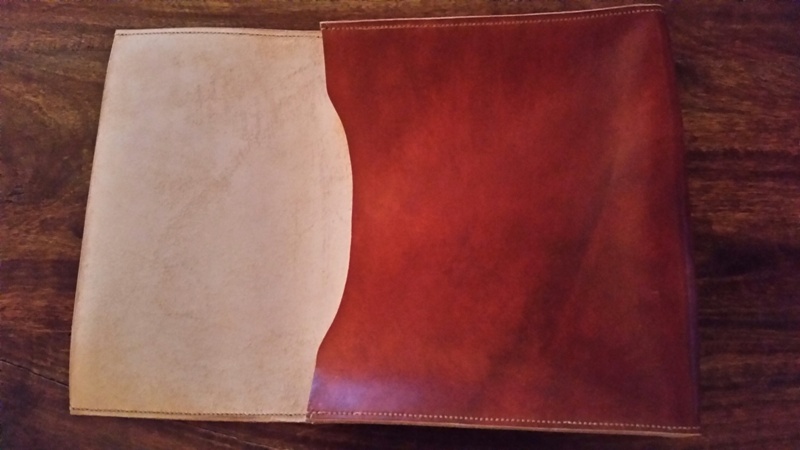

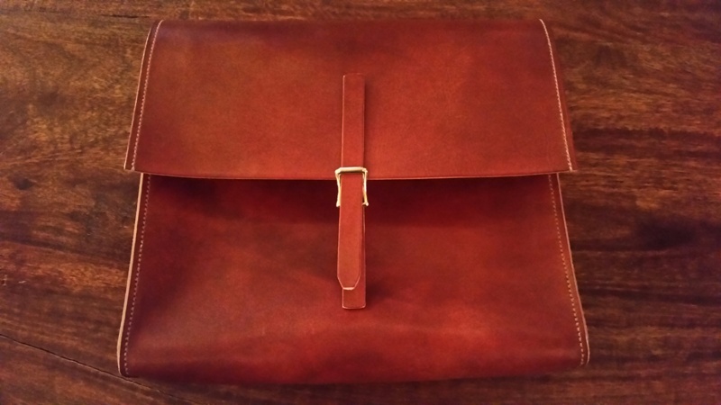

  12. Thanks for the compliments. Boy are my wrists and neck tired! I have finished the portfolio and gone on to make a few wallets. My next project is a double-gusset briefcase. I dyed the leather yesterday and will be cutting and fitting this weekend. Here are a couple of pictures of the finished portfolio:
  13. Thanks, that is hand stitched. I have burnished the edges with water, but I am looking for something to make them slicker and last longer. The leather is some veg-tan out of the scrap pile at my supplier. They said it was something Italian, but they were selling it cheap because it had a blemish in the hide. I chose it because it is pretty smooth inside. The main problem I had with it was getting the bottom of the gussets stitched evenly. They look pretty crummy, but I guess that comes with practice.
  14. Well, on my way from wallets to briefcases, I thought the logical middle ground was a portfolio. My wife needed one, so I thought I would oblige. I made some mistakes along the way and am still dreading fixing the last one. I didn't have the latch planned out when I stitched it and my wife decided she wanted a strap with a buckle. I will have to crane my wrist inside the pocket to stitch the lower portion on. I would have done one strap all the way around, but that would have been murder. Anyway, here are some pictures...
