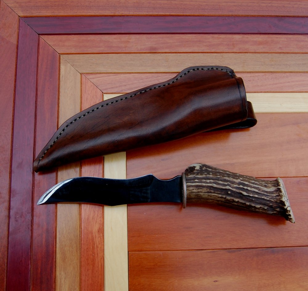

Thanks, Cheryl-- don't know why I didn't see this sooner. The knifemaker sold the knife today and sent me a picture of it with the sheath. So I do have a picture.- 4 replies

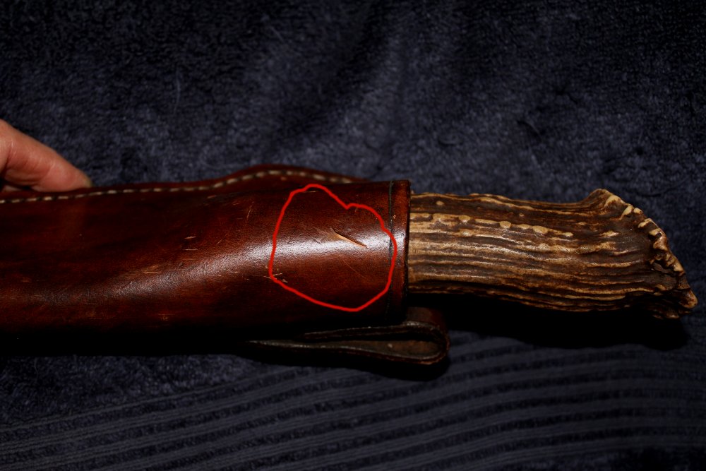

Thank y'all. I've got the same dye, and I'm gonna take that advice about the superglue on a toothpick. My biggest worry was that it would catch on something and tear off and look worse. And, thank you all for the encouraging words. I love doing this. I see my job as a sheathmaker, as well as making something really useful (I don't like straps and studs or snaps cuz they're a pain in the butt in the field, so I like to get them to hold the knife tight even upside-down, but still go in and out easily), but also, like a picture frame. I try to make something that helps it look good without distracting from the beauty of the knife and handles. The guy I work with makes really attractive knives. This one has an old two-centavo piece with an eagle on it set into the antler crown, and it's a 52100 Bowie. I can get pictures of it easily, if you'd like to see. Thanks again.
I made this knife sheath a few years ago, before I knew all the things I know now. Still, it's a big knife, and the antler made curves and nothing's flat or straight, so I was pleased to make a sheath that fits this well and is handsome. I deliberately didn't do any stamping or tooling because I like the dark leather and the antler just like they are. My partner's had an inquiry about the knife. It's been put away for a while and tonight I noticed a little flap-cut near the top. He asked me if there's anything I can do for it. My first sense is, anything I try to do is likely to make it more visible. If someone's got a good idea for me, some kind of glue I could slide under there maybe? I might be brave enough to try it. Thanks in advance.
