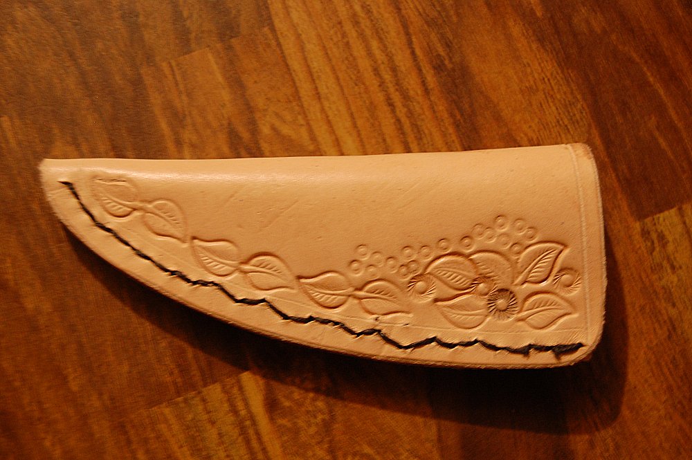

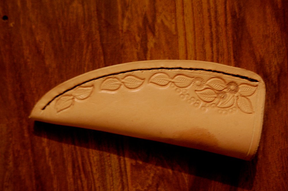

MorningStarL posted a topic in How Do I Do That?
This isn't finished, but I thought what I'm asking about would show better if I took pictures now. This is a knife sheath with no belt loop, for someone I know to carry a knife in pocket or purse. That means there's no front and back; they're both going to be fronts sometimes. The tooling's more than I usually do, but I miscalculated the distance between leaves and needed to fill at the last moment, then did the other side to match. I've just started using an awl for sewing holes and I'm having the same old problem. A knife sheath isn't flat or regular in contour. I'm not always able to flatten them enough for the hole to go straight up and down. I'm pleased with the "front" of this, meaning, the side the awl went through from. Very pleased, actually. In the back, the stitch line wanders, and I did do three of the holes twice, because they wandered SO badly. I'll be grateful for any input.- 17 replies
