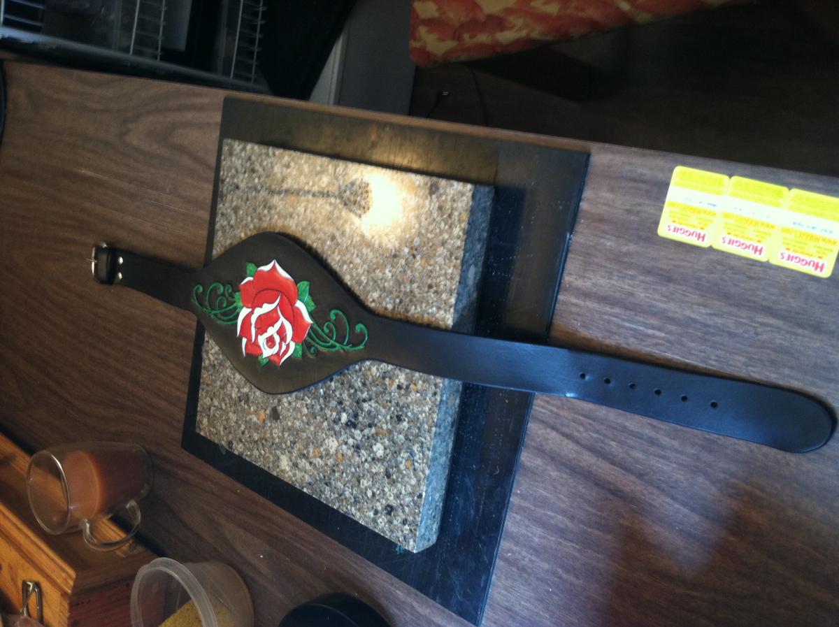

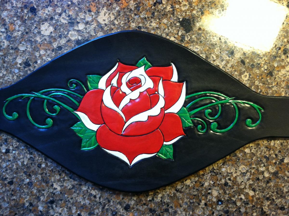

Thank you both! What I ended up doing on this project ( and the cincher belt ), was dye the entire thing black, then used acrylic paint for the letters/rose. It took a few layers of white before I could start adding color. I had found that gum trag does NOT work as a resist at all. Super shene takes many many coats to resist as much as I need/want it to but works well! I have found that super shene doesn't work well as a resist against dye but works well with stain. The 88 wallet I dyed coal black then layers of white acrylic paint before I could paint the 88 red. The vacuum truck tally book cover I dyed black after tooling then used probably 6 or 7 layers of super shene over it and the rest of the truck before I stained it saddle tan. Next time I am going to try a layer of super shene over the dye before I paint it am see if that helps with the dye bleeding into the paint. Hello again, btw! I am posting a new one in critique my work. I need some pointers on it, you ought to check it out! I'll title it Indian Deer.

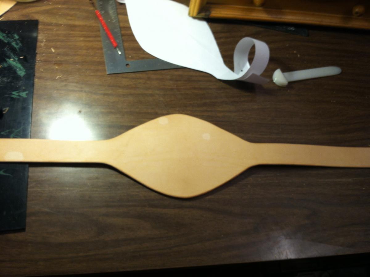

I got it in my head that I wanted to make this belt style and within two days I did! I'm fairly new to leather working, and this is my first belt. I used Tandy's belt sizing guide to measure myself and draw a belt template for 29" waist, and it fits perfectly! I used 8-9 oz leather, coal black dye, and cova colors, as well as super shene, black edge kote and gum tragacanth. I don't have a good wood burnisher so my edges aren't as nice as I'd like them to be, but considering I cut it all by hand I think the whole thing turned out well.
Pattern- I made my own last night. I pulled out my Tandy guidebook that has belt directions and wen from there. Design- I'm drawing up a rose now. Leather- I used 8-9 oz as I felt like 6-7 oz would be too floppy. Tools- check. Edging- working on evening and smoothing them out. Dye- check. Finish- check. Hardware- I've got a center bar buckle to use until I order one I like better and am making my own keeper. I feel like the oval(ish) center didn't turn out too well. I've been working on getting it more even but I'm such a perfectionist it could take me forever and I'd still not be happy with it! My pattern was spot-on but transferring it to the leather I think distorted it a little more than I thought it would. I've got my center hole punched in as well as the buckle tongue hole.
Hi all! I've got it in my head that I want to make a waist cinching belt. I don't need/want it as a waist cincher, I just really like the style. I have an idea how to go about it because it seems pretty simple, but I know I'm overlooking something. Any tips? Thanks!

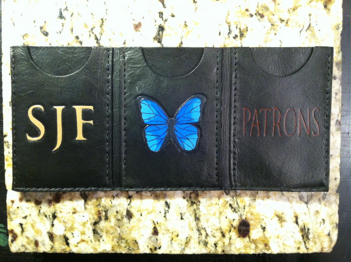

Here's my attempt at the pattern. I had a lady ask me to make her a business card holder for her boss. That turned into "stringing" three of them together so I suggested a trifold wallet type holder. I searched online and found this pattern and was immediately sold. She said it doesn't even need to fold because her boss carries huge purses, so I made it with 3 oz. It was my first attempt at a wallet! Each pocket on the inside is for her three different businesses. The pockets on the outside are for credit cards, and, of course, there's the bill pocket.
