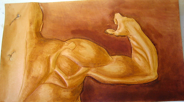

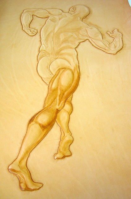

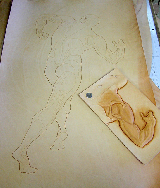

I started applying dye to the anatomy study - all the tooling is done! I redid the coloring on the test piece first, because in the first color sceme the body appeared too yellow. The new test piece looked much better and I could get started. It took an hour to do the two legs, but I will have to revisit them now that the dye is dry and I can see its true hues. I think I am over tha half way mark! JOhan
