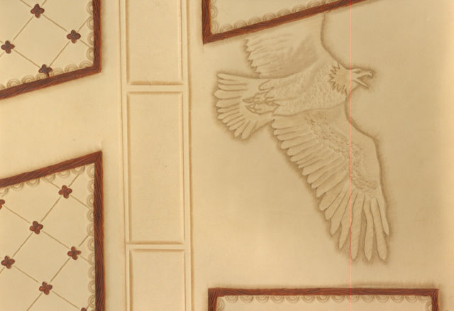

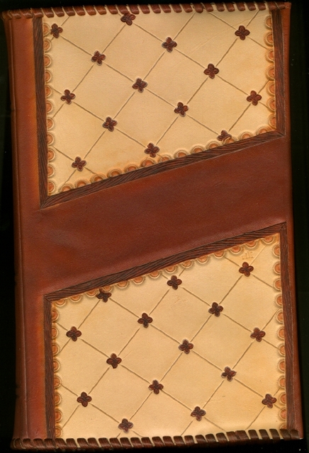

This was a cover I made when asked to have an eagle with open wings on the cover. Not easy when you start looking at designs - the cover is too small to have a sensible pic of an eagle on it. Plus I had to have the wording on as well. So I cheated and only put half an eagle on. And it worked, I asked my friend a while ago what I put on his dad's Bible Cover, and he remembered an eagle with both wings spread and both visible ....
