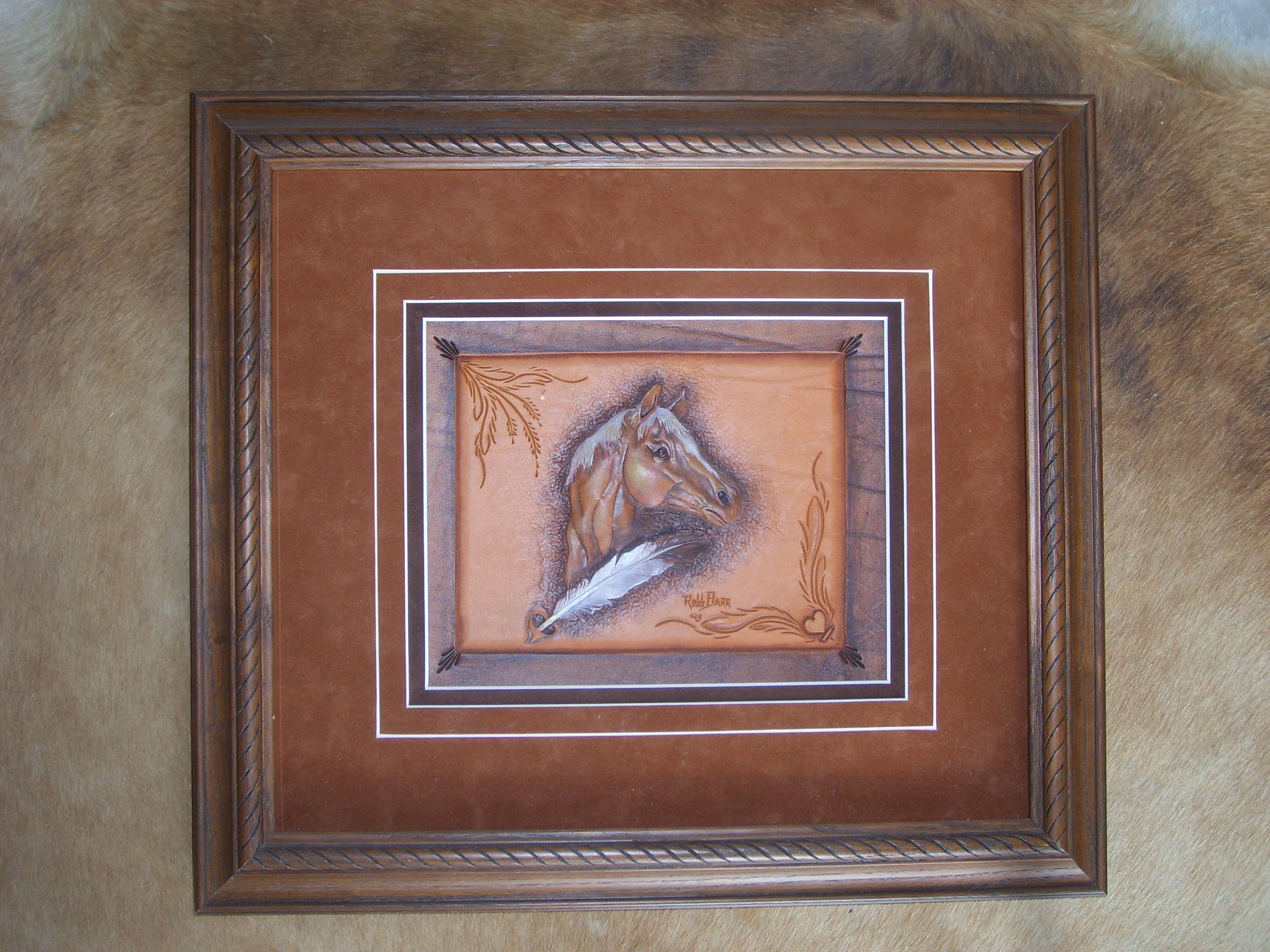

I have this listed on ebay. Just putting the word out that I have a piece for sale. I know it is hard to sell leather work to a leather worker, but there are not any more of these ever going to be made. A fine piece by Robb.
