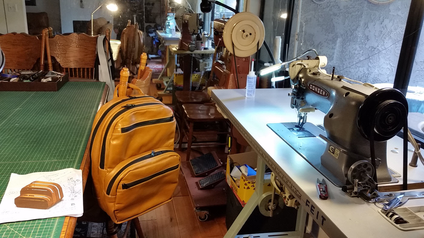

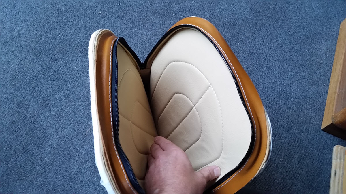

So I was able to finished my 2nd attempt (ever) at a reversible, silk lined leather packback with my two new sewing machines. I bought a used Consew 226 /w reverse and a Cobra 16 cylinder arm (also used). I had two big issues with these two new machines that I was hoping someone could school me on just a bit. · On the Consew 226 the hand wheel is very hard to turn while sewing. On both of my other sewing machines I have “hand wheel turning” is very easy to do. The Cobra has a nice big hand wheel and is effortless to turn and even my old Sailrite LZ-1 is very easy to turn. But this Consew 226 is almost impossible or at least a real pain in the butt. If I take the belt off the wheel turns quiet and smooth “like butter” and I just went through and oiled the whole machine top to bottom. o Is the Consew 226 hand wheel being so hard to turn normal? What is the best fix? · Next problem I had was with the Cobra and sewing only two layers of maybe 5 oz. garment leather. The presure foot does not lock the material in place under the presure foot. You can simply slide the work out from under the foot (while the presure foot is in the locked down position). The presure foot starts to grab/hold when I use three layers of material. I know you can play with the alternating walking foot heights but how do I get the whole foot to come down farther so it pinches only two layers of thin material ??? Thanks to anyone with some answers. jeff
