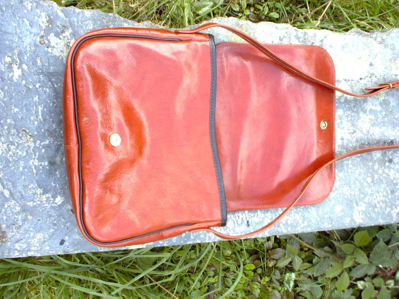

Ladies Shoulder Bag
SteveBrambley replied to SteveBrambley's topic in Purses, Wallets, Belts and Miscellaneous Pocket Items
Thank you all, very much! Steve -

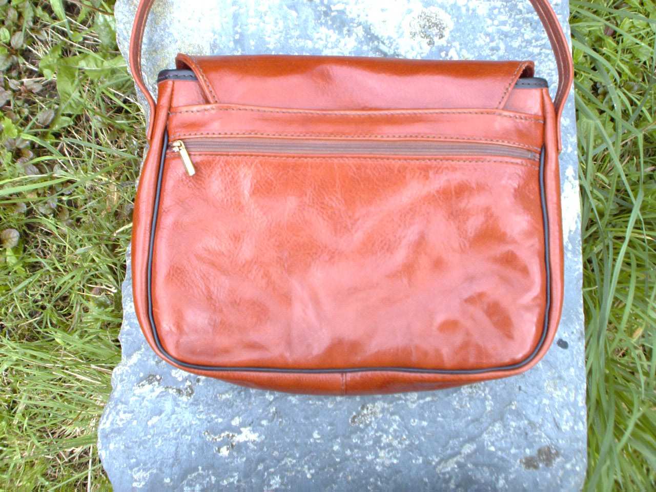

Ladies Shoulder Bag
Thank You. Steve -
